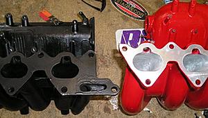

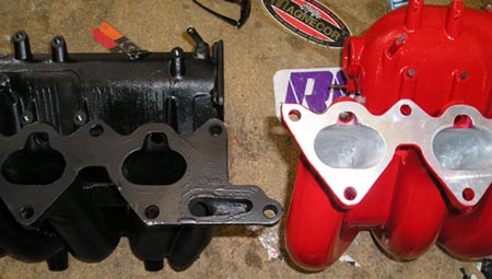

Shingen. I do not have proof and nor do you. Power curve in theory should be better top end on a 4G93 manifold but I THINK YOU GIVE UP LOW END. This is what others have reported. As for the ports, there is not enough material on a 4G93 manifold to port to the size of a 4G94. Believe me I can care less except please do not claim blind worship of us. It is not us vs 4G93. But right now you are ask people to blindly worship 4G93 manifolds. Think about it. Someone should do dynos back to back. Maybe I will utilize a flow bench to illustrate things but I do not have a 4G93 manifold. We had DemisedGabe's ported mani from A2 so we took a picture side by side. I guess you and I will just have to let other's decide for themselves and try each. I sell 4G94 but I could sell 4G93s. I just don't want to cause no one has proved it better yet. I am open to it though!

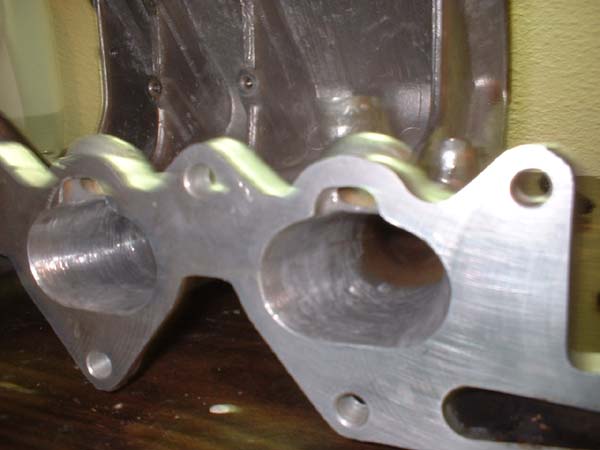

I found this pic in the Lancer/Mirage forum. This IM is ported. It looks like the one in the other photo on this thread isn't. Now, does this IM look like is has larger openings then the RRM one?

TO clear that up. That was A2 idea of ported yes. Was it NO!. Regardless having them next to each other and measuring thickness of material and ports with calipers etc showed that 93 runner material is not thick enough in some areas to port to the size shown on the red manifold.

Thanks for clearing that up Rock. I'm sure alot of us that planned to purchase parts from A2 are glad that we didn't. Its the pics I posted, the 93 was pretty heavily ported. Are there any risks of the mani failing due to the thickkness of the metal in the runners?
Sure it is possible. We have accidentally ported through a runner before and had to trash the manifold.
