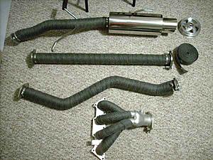

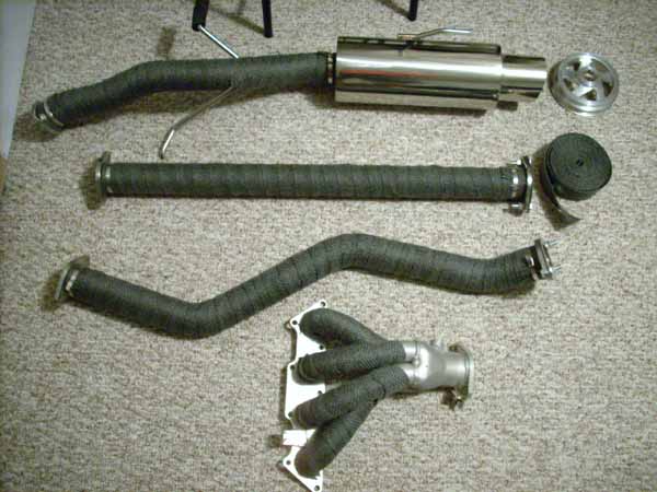

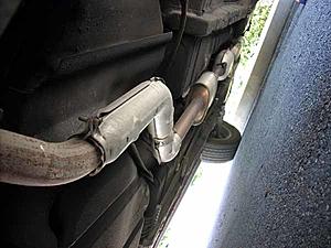

Stock Setup
Ebay System (It doesn't come heat wraped - I forgot to take pics b4 i wraped it).(excuse the RRM headers and pulley)
Ill post pics of the ebay system installed as soon as the sun go down. (to bright for crappy digi cam right now.)

Nice job with the heat-wrapping. Makes it look badass.

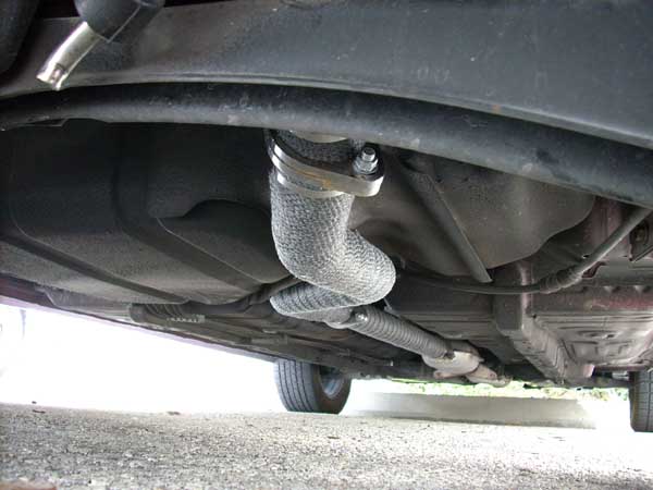

TY Blacksheepdj I thought so too. I did it to reduce the heat affect on the cabin (even though I know our motors dont put out that much heat) due to the large pipe diameter and it being position closer to the floor but mainly I did it for the look.

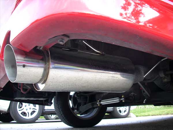

Here's the install pics:

what size tip is that? it sound pretty good... Is that where it would normally hang or did you drop it a little so as to not burn ur rear lip?

Tip = 4.5 and its that low because my stock hangers suck and I haven't recieved the Kartboy ones yet. The stock beast of a muffler was pwning those stock hangers.

I got 100ft of 2in wide black 1000 degree F and still have some left over. I would recommend though if your going to wrap a header like I did the RRM one use 1in wide wrap because 2in wide wrap is difficult to work with those bends and would not be as neat (Ill rewrap my header another time so I can wrap the whole header from flange to flange).
