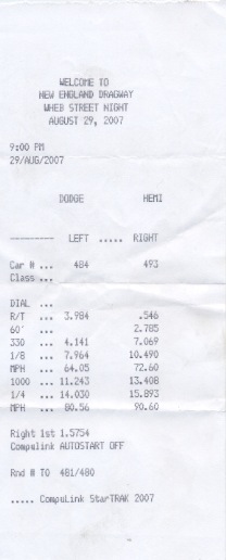

okay, now that i am fully awake what is this bull****? almost a four second reaction time? no '60 time? what the ****?!
something looks wrong here, who can tell me exactly what they ****ed up?

They blocked the timing light until after your passed 60' thus no 60' time. What was your reaction time on the second run? to get a semi accurate time for this run take the 3.9 second reaction time subtract the reaction time from your second run, and add the difference to the 14.030. I woudl guess about 17.something was your correct time.

my r/t was .502 on my second run. i can't really use the time from my second run because i missed a shift. too bad we only got two runs.
so what this comes down to is that someone stood there and so my time didn't start when i left the line but until after i'd gotten 60'? that's ****ing stupid! my first run ever and i have to deal with that... lame.
thanks for clearing it up for me though. i'm PISSED.

I might be wrong so someone should verify but I always thought tracks dont literally count the time it takes you to start and end on the drag strip
I thought it was a whole math formula like when you trip the light then it times to 1/8 mark or whatver and speed etc and then it does a formula to post a time. I may sound a little crazy but I thought thats how it figures this out so using a stopwatch might yield different times
but yeah in any case low 14's is definetely not possible with those mods. I needed a turbo to hit that

oh and yes the timing can get thrown off a good amount if she was messing with it cause I had that plastic crap come undone from underneath my engine and it was flopping around tripping the lights depending on how it hit the light or if it didnt hit the light
I was wondering all night why I couldnt stage properly and my times were off by as much as a second! until I saw video and realized the plastic came undone.
