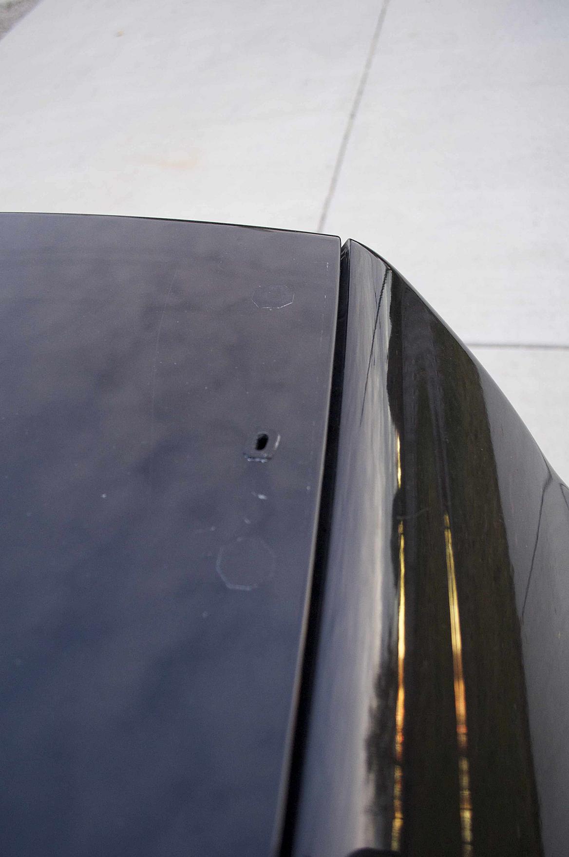

Haha you were right about the finger nails. I just added the fin from rexspeed. Now the question is, how do you cover them holes? Any pictures????

I know right my thumb nail is still messed! What color? Mine is TB so i went to the local craft store and bought a sheet of black vinyl, but they have all sorts of colors mine ended up blending really well, if your standing right up on it you can certainly see it but stand back a foot or two and it looks completely flush. the vinyl is good because it is sticky enough that the elements wont take it off but if you want to you can do it in seconds. it also doesnt leave residue and wont take your paint off when you try to use it.

here is a picture
