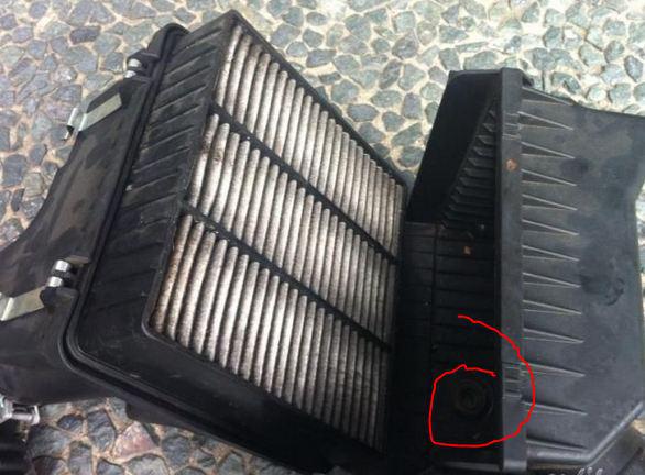

This is the Evo forum, so probably not
Here is what an Evo one looks like, it is obscured on ours.

I know, that's why I said you wouldn't have much luck asking in an Evo forum.
In the picture I posted you can see half of the rubber donut tucked into that box. On our cars there is a post that slides through the donut in that location. Yours will be similar with exception for the different box design. 3 donuts, two on bolts on on the hole that the post goes through. They are all like that, I just don't have a Lancer picture handy.

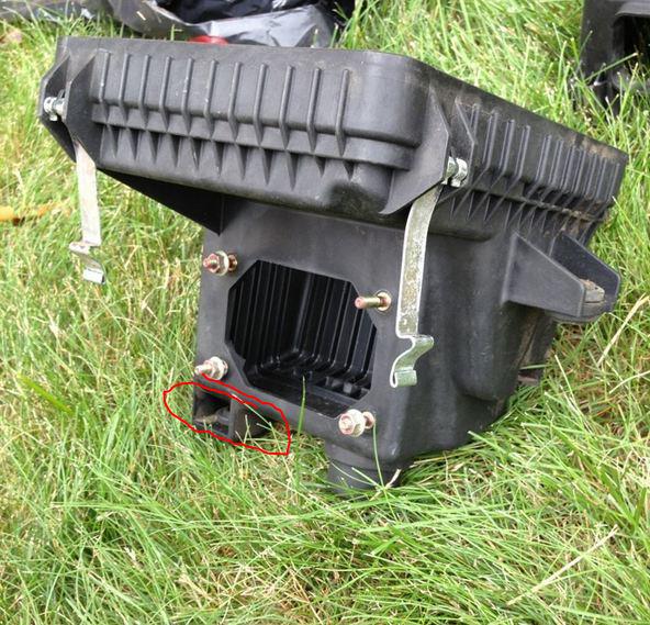

From: Florida
Hah, found one a bit more like yours. This is from a foreign market 1.8 but is much more similar to the US 2.0 than the Evo. It is dark but you can see the rubber donut installed.
Thats it exactly! So I am guessing mine fell out?.... where in the world would I get one of those to replace it? Any chance its the same as the donuts on the bolts? I went to a dealership earlier today and they had no idea in the parts department if there should be one on there, they looked up parts for the air filter box and it wasnt even in the diagram....

Mitsubishi. It's like a buck.
Yes it is identical to the one on the bolts, all three are the same part.
MR450097
