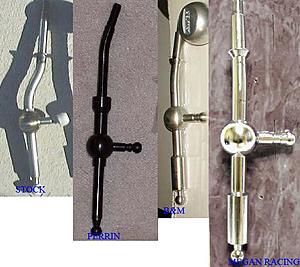

this pic may help?

judging by those pics i'd say it must be stock.

The S-Bend is the biggest tell tail... Also - the aftermarket ones have signs of machining more heavily than the stock, cast and turned ones...
