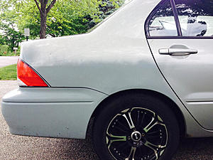

What height does the lancer come stock ? I'm kinda thinking that the previous owner may have lowered the car I'm not sure. My 2002 lancer already sits lower than my friends rsx at his stock height .
I can fit my shoe under the front fender but not the back .
Btw I have springs with a 1.5 drop sitting in my garage but if it's already lowered I'll just sell them backk ??

Our Lancers are supposed to be about 4.9inches off the ground according to edmunds.com. I'm assuming this measurement is from ground to sub frame. However keep in mind that worn suspension can make the car appear to be somewhat lowered & the fact that you already have bigger wheels/tires means that you may have already eliminated some wheel gap. On another note our cars have a bit of reverse rake stance going on so that could also be what you're experiencing.
Other than what I have mentioned, the only way to know for sure is to get under there!

Hmm looking at your pics again....I don't believe you are lowered.
