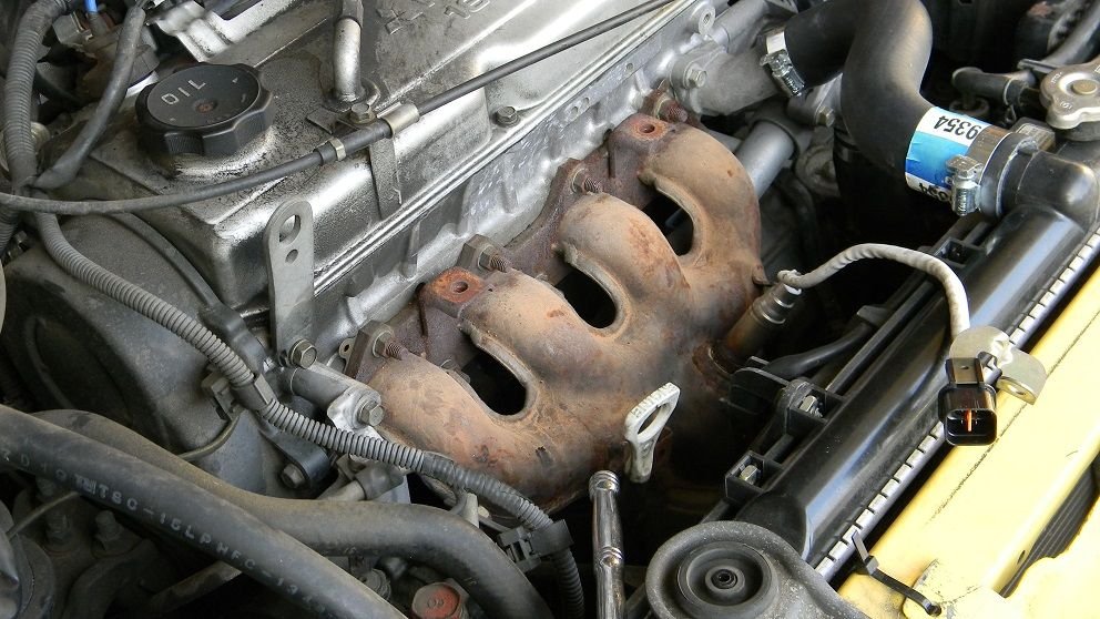

if turns don't work, to make it easier, change all bulbs involved front and back. remember driverside turns/hazzards are linked to rear
as are passenger side, so if one is out/bad you get rapid blinking etc. the header is a easy swap once you get past the bolt from hell.....
here is a image ( from 2015 )of my oem header, what you don't see ( you will on 2nd image ) is bolt from hell. to get that out
you need a offset wrench ( I bought a whole set to add to my tool box ) to get that out. once its out u don't have to put it back in...
I hope you have a set of tools available cause you will need it. esp a offset wrench and a o2 sensor plug socket
here is a video of me replacing my header ( unbolting of old header ). remember to take your time... getting that bolt out took longer and didn't have video, too much cursing lol
Old
New/replacement
hope some of this helps....
