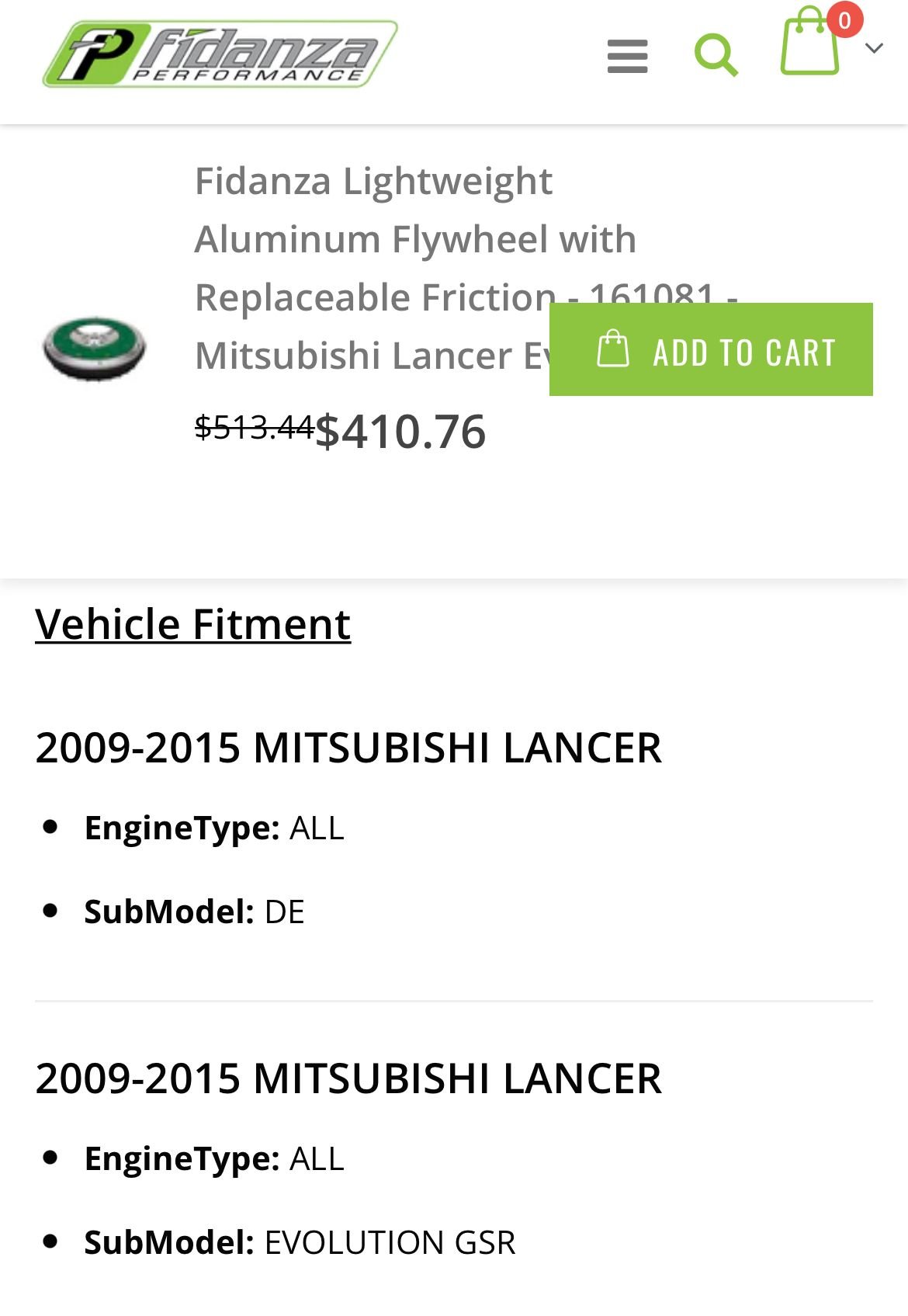

I bought a ACT Evo X Flywheel and the mechanic said “it doesn’t fit” but the seller said it should fit, and I’ve seen that others like Fidanza offers a Flywheel that apparently fits both the Evo x and the Lancer DE. So now I don’t know what to believe.
If they are not the same why some manufacturers say it will fit both and even the OEM specs of some years says it fits both?

@Sonis
Searching this site here: https://partsouq.com/
I came up w/this flywheel: MN163878
Search up your car there & double check
Cheers
