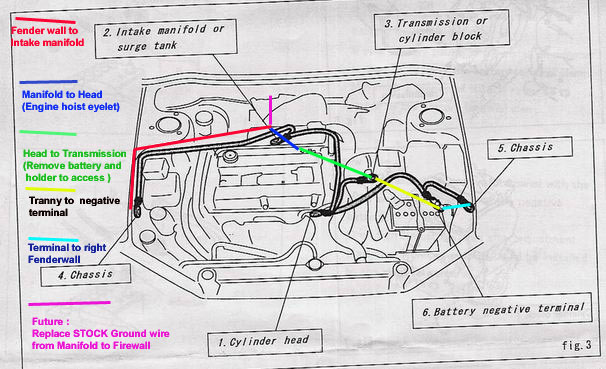

Lookie Here:
(Also I didnt know until I read this picture that, theres a stock ground from the Firewall to the to the Manifold... I hadnt removed that one.)

Neg. to Tranny
Tranny to Head
Head to Throttle Body
The Alternator goes soley to the Neg. Terminal.
As the picture illustrates to go to the Firewall, and from the Firewall to Pass. Side; Thats when It started givin' me problems... So I assumed it was a double ground thing, cus the battery is already grounded to the body primarily.
I did see your How-To.
The illustration above, was taken from a similar thread which you also posted in.
I think it was the one where JChangsta asked about what grounding is for...
It was all fine until I Grounded to the Firewall and then from there to the Pass. Side Frame, as it illustrates... and then ZONK... It all went to hell.
