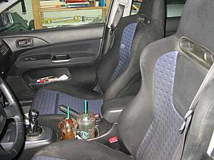

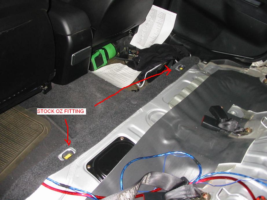

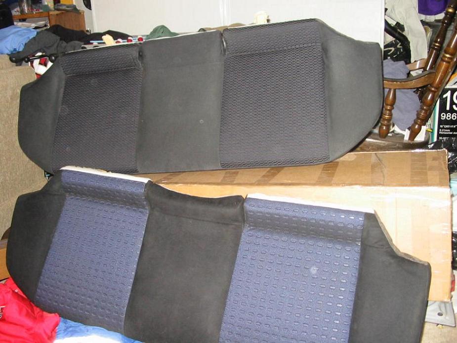

Sorry it's taken so long to respond, been pretty busy with work. All right, first of all I purchased the seats for $560.00 on ebay, EXCELLENT DEAL! I contacted the dealership and purchased the locking mechanism for the lower bottom seat for the Evo. I'm pretty sure I can replace my stock Lancer fitting with this Evo one. The attached photos show the current front seats installed (no problem installing, look pretty sweet) the fitting in which the seats mount, and both the lower seats with the connecting device. I pick up the replacement part today, I will let you guys now how it turns out and if theres any more problems! THANKS ALL! - Brian

FINALLY FINISHED. Just replaced OZ fitting with EVO fitting and the seat with a little adjusting went in nice! Looks great, nice to have an interior of a $38,000+ car. I will post pics soon, and answer any questions as to how I secured the interior without altering the car.
