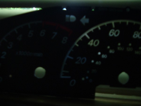

7. Colors I have tested:
Brand-Delta Cermcoat....Color: Bright Red Rouge Clair Transparent...Works with stock bulbs without blue gel caps
Picture of Needles lit with this kind of paint and stock bubs (just pay attention to the tach for color)

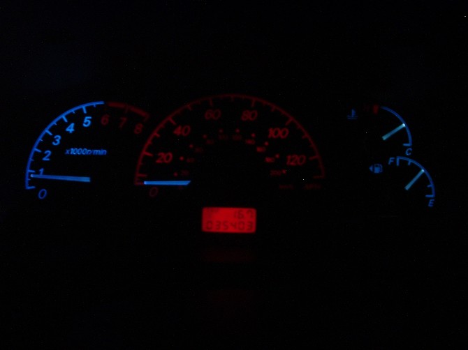

Brand-FolkArt....Color:2225 Ocean Cruise....Works with HyperWhite LED Kit by Lightrikz
Needles lit with this type of paint and LED Kit(gauge faces are not the same):
Both paints were found at HobbyLobby for around a $1 a piece. *NOTE: The lights used behind the gauges will alter how the needles light up. For example the speedometer in the first picture is painted the same color as the needles in the second picture. The only difference is the stock bulbs are used in the first picture and the HyperWhite LEDs in the second.

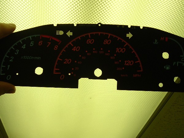

5. While you have the needles removed the gauge face can be popped off by gently applying pressure upward by the bases of needles. You'll know what I am talking about once you try to do it.
Two Options: Follow steps for Route #2 dealing with the alteration of the gauge face (which I did not test with the stock bulbs) or do what I did with the stock bulbs and continue on to step 6.

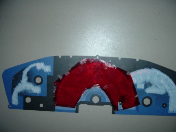

6. Once the gauge face is removed you should turn it over. Cut the theatrical gel to cover places that the light will go through. I then used a glue stick to attach the theatrical gel to the gauge face (I know it seems pretty primative but it worked really well). I would pinch off a little of the glue with my fingers and would apply it in small amounts to attach the theatrical gel. It will probably look kind of sloppy but that really doesn't matter. Just make sure you are not getting glue over the parts that light emits through. You can also use multiple pieces to fill in a spot if you mess up so don't worry. Be sure that the pieces align and don't overlap if this is a spot that light needs to go through. I used two layers of theatrical gel for the stock bulbs to give it a deeper color. Pictures of what the back of my gauge face looks like can be found in Route 2 as reference.
7. Hold up gauges to a light and see how the light comes through the numbers to check to make sure you did not miss a spot.
Picture of Gauges with One Layer Theatrical Gel with Needles painted with Brand: Testors...Color: 1352 Fluor. Green...Stock Bulbs (the Needles Light up a Yellow/Green...Odometer bulb still has blue gel cover on it
Picture of Gauges with Two Layers of Theatrical Gel (same blue as used in picture above) with Stock Needles and Bulbs...odometer bulb still has blue gel cover over it

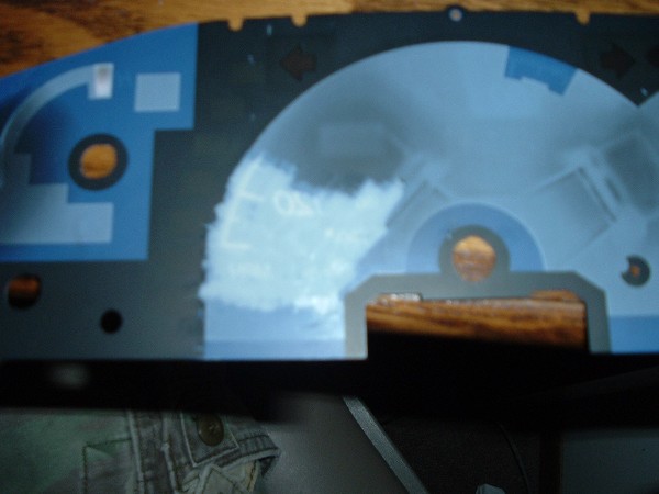

5. Here is the modification: Take the pocket knife or sharp object and scrap off the back part of the gauge till it becomes white. Make sure to scrap off every part of the gauge that has light showing through it.
Picture of what the guage face looks like with part of it scraped off
Picture of Difference in the type and amount of light that goes through the gauge face with the back scraped...*Note: that the same amount and type of light is going through the gauge face

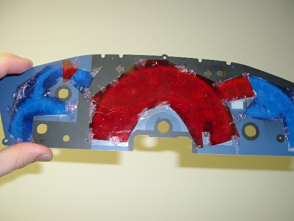

Follow step 6 of Route 1 except only use one layer of theatrical gel
Picture of Modified Gauge with beginning of theatrical gel application
Fully covered gauge (I know it looks bad but the next picture will show that it doesn't matter)
Picture of checking for no missed spots
