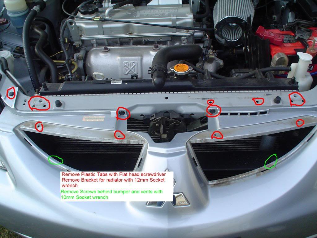

First step is to remove the plastic tabs from the front bumper. I included some extra steps for the radiator bracket because I have one of those heat shield panel things on there which had to be removed. Otherwise, you don't have to remove the radiator bracket. There should be 8 plastic tabs to remove. Behind the vents are some bolts you will need to take off with a 10mm socket or phillips head screwdriver.
Next, use a phillips head screwdriver to take out the screws to the fender well liner. There should be 2 screws. You may have to turn the wheel to get good access to them. Above the 2 screws is a bolt. Use a 10mm socket to get it out.
You should be able to pull down on the bumper and it will start to come off. Go to the other side and repeat.

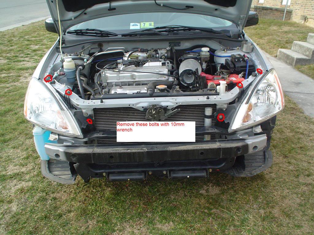

Next, under the car, you will find two retainers. Use a pair of pliers to pinch them and remove them. I don't have any pics of under the car, but here is a pic of livelyjay s write up on his 02-03 bumper removal

If you are removing you headlights, make sure you unplug the 3 connectors behind the headlight before you take it out. There are 3 bolts. Use a 10mm socket wrench to take them off. The headlight does have a prong that pops out when you pull the headlight out. Don't worry what that sound was.

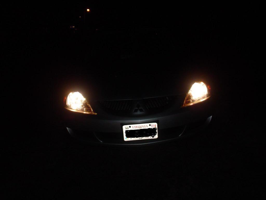

My finished product.
