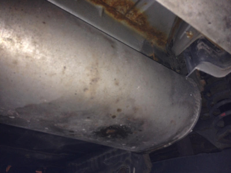

I want to install my SRS Catback exhaust I know it's a bolt on but anyone have any instructions . Not sure where to start and where exactly my car is cause I know there's there's a picture .

just start from the cat, unbolt 2 of the bolts facing the rear of the car and once those are off take your hangers off and the whole system should just slide out

As long as the old exhaust is bolt on all you need to do is unbolt it and reverse the process for the SRS catback. If it is welded then you will needed a sawzall or something to cut it in a few pieces to remove the muffler which runs through the rear right control arm (or something of that nature).
