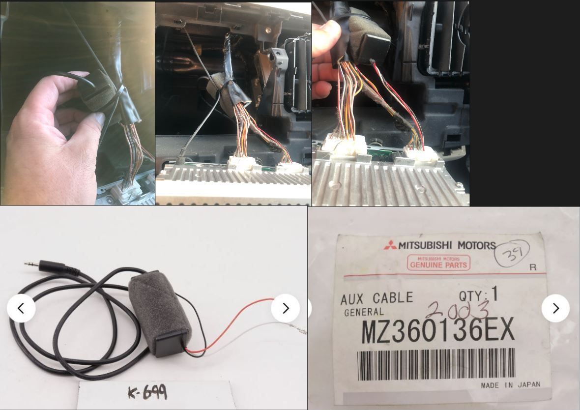

Mp3 Plug - Cord
So I pulled out the stereo. It is a plug with 3 wires (red, white, & black) that come of the plug, and go into one of the plugs to the wire harness. I'm attaching a picture to show you what the plug and wire look like. I found the part on Ebay & included a the part and OEM number. I'm not sure about my skills of attaching a new plug. I may have to find someone that can do soldering. It might be easier to splice in the New main wire.

Unfortunately when I moved the face of the stereo, there is a ribbon cable, I damaged the cable. I did a web search and found on Evo-X-forums a response about the cable:
" It called FFC (flat flexible cable). You need 8 pin, 1mm pitch, and the length depends on what you're doing. Relocating the hazards I'm assuming? Or did you damage that one and looking for the same length? "
I decided to go with a longer cable, since the original was tough to work with. On Amazon I ordered FFC Cable 8 pin, 1mm pitch, 200MM Length (it's almost 8 inches).
I'll have to find someone that's good at splicing on a new cord for the MP3 player. I found OEM on Ebay bout they are $50.. Might be cheaper just splice in the Mp3 wire.
