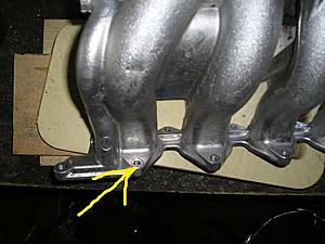

Now the fun begins! I think we have all of the hoses and wires off, so lets start taking the bolts off. I started on the left side (as you face the engine bay) and used the 12mm to take that upper bolt off. That's the easy one. Then I went to the right side. There's a bolt under the fat hose that you can get to here. You may need to use the ratchet wrench but this one is also fairly easy, and it's the one I missed, causing quite the headache for about an hour while I tried everything I could think of. Here's a "map" of the bolts for you.

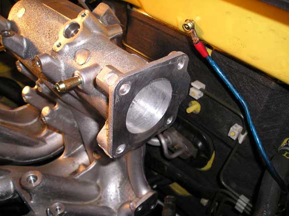

Here's a look at the IM when all the bolts are off. The "bolt from Hell" is the one with the arrow. Look to the left and you'll see the bolt that I just had you take off. Now you're thinking "Hmmmm... those three nuts on top seem easy enough to remove" But save those for last.

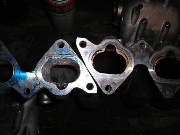

Here's what the stock IM looks like compared to my ported IM:
You can see the buildup on the stock IM, this is obviously just getting in the way, so I ported it off.
