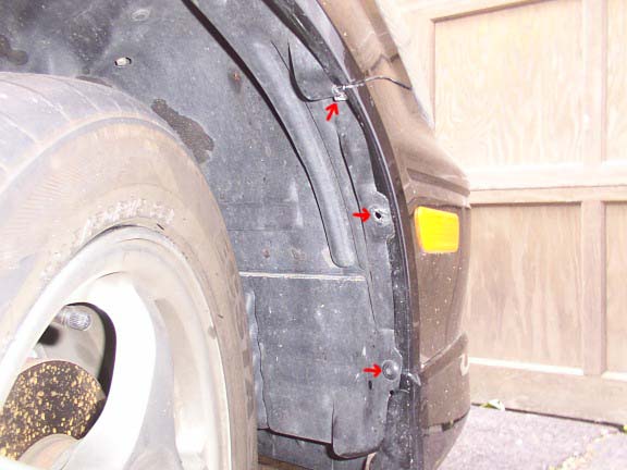

2. Remove metal screw and plastic retainers from passenger side
* Use either screwdriver or ratchet to remove the one metal screw holding top side of bumper to fender (top arrow in picture)
* Use phillips screw driver to remove plastic screws from fender lining (be careful because the threads are easy to strip) (lower two arrows in picture)

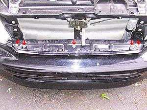

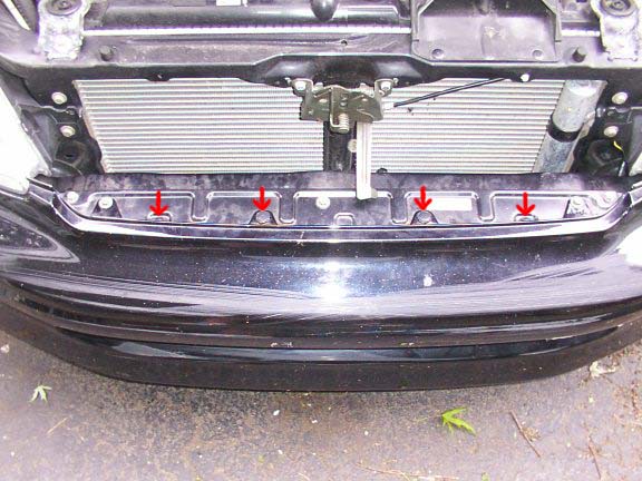

5. Remove all five bolts you see between the headlights
6. Remove all plastic retainers using the flathead screwdriver

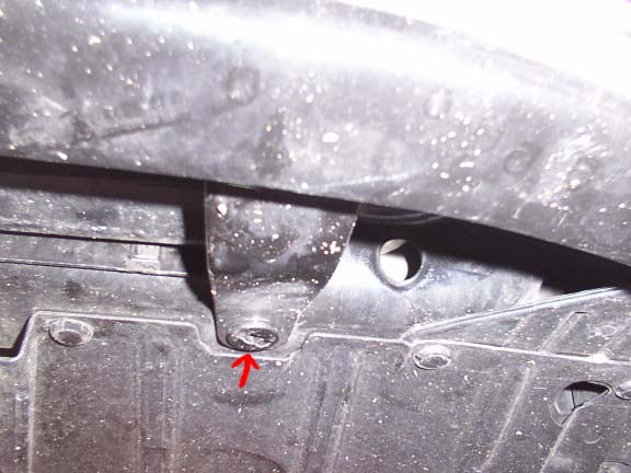

7. There are four plastic retainers that are left holding the bumper on (picture shows approximate locations).
Look under the car and you will see two flaps going from the bumper to the bottom of the car.
Use the needle-nose pliers to remove the retainers.
