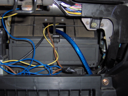

Yep I checked them but the engine's heat must have burned through the thin wires. I was using the same fuse that came with the kit but when the wires burned I just re-wired the lights to my parker bulb. Now I just need to put the wires through the firewall.
What hole did you put it through? And how many holes are there in the firewall to choose from?
I used the one behind the glove box. I think there's another behind your pedals...
This pics is from a few years ago... It's been cleaned up a bit since then...

Does any heat get through to the glove box or the passengers feet?
Oh I see...
Not really... In the winter you can tell it's a little bit cooler there but no biggie

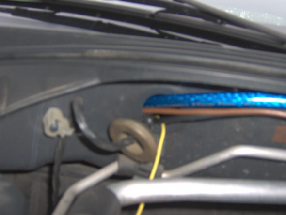

I tried to do it a couple of days ago but I couldn't find a spot on the firewall. So I guess I'm gonna just leave it the way it is.
grommet on the top left when you are facing the engine bay
I used the hole where the cable for the hood release goes thought the firewall on the driver side. Works well I have multiple wires going through there for power to my interior and under body neon's.

That's a good idea. I have to check that one out
