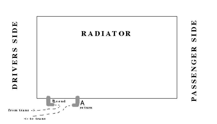

2. Get under the car towards the driver side, and take a look at the bottom of the radiator. Get your bearings, and compare to the attached diagram
3. Hose B is the line coming from the transmission, pumping fluid into the radiator for cooling. Hose A takes that coolant and sends it back to the transmission.
4. Take a bucket and lay it under the radiator, under the connection for hose A.
5. Take the pliers and pull hose A off the nipple/connector thingy on the radiator. Transmission fluid will begin to drain out into the bucket/pan. Let it sit there and drain.
6. When it stops, take a spare piece of hose, and attach it to the nipple/connector, then somehow secure the other end of the hose so it is pointing straight down into the bucket. When you begin to flush the transmission, the fluid is going to exit the radiator with some force, and if it isn’t re-directed into the bucket, it will spray all under the engine bay.

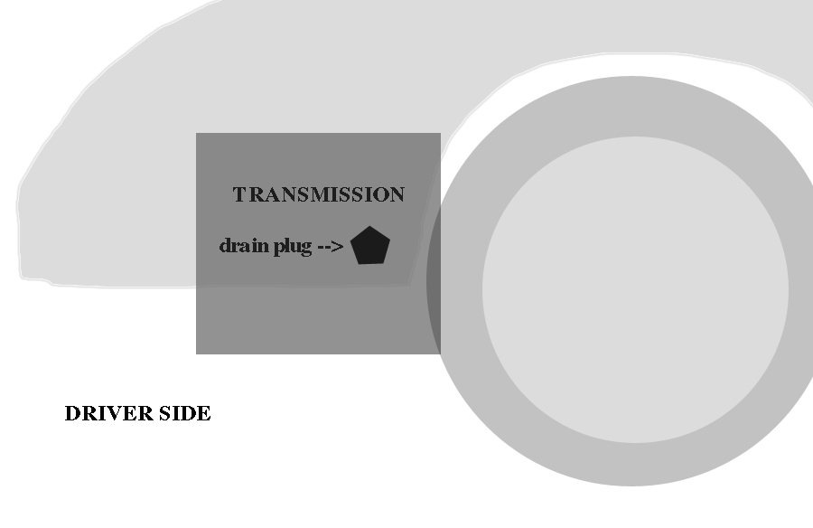

10. Go under the car, next to the wheel, on the driver side. Look up, and you will see the transmission. There is a small polygon’ish drain plug on the side of it. Take your bucket or pan and place it roughly under the transmission. Don’t worry, the fluid will drain pretty slowly, so you can maneuver the pan once it starts draining
11. Take your socket, and unscrew the drain plug. NOTICE: There is a small metal gasket on the plug DO NOT lose it. Otherwise you will have to buy another one

24mm socket for the drainplug.
12mm socket + long extension, philips screwdriver to get at the splashguard
