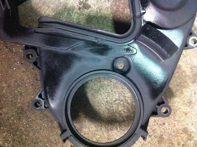

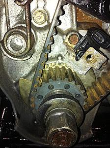

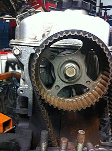

i havnt seen a sticky or thread on how to do the timing which is strange
but im trying to do it now and im a little confused.
i have this motor and what im rele doing is checking it to make sure its right but if u take a look at the pics u might say its not but then again who would no.
the motor has run.....it was done by a shop.....cam is stock......has a valve kit in it...
but...for some reason when the cam gear lines up, the crank sprocket is about a tooth away and on the plastic cover, it reads near the 10 mark
Does that mean its been degreed or its off or what? it is a fully built motor so degreeing it would have been an option......the time i had it idleing, it seemed fine. problem was i couldnt rev it and it would eventually die.
the crank sensor must of gone bad bc there was no spark after that and when i took it off it was all rusted and what not.
take a look at the pics and see what u can add to this please.

I don't get the plastic cover part....
But, anyhow, the guide in the manual seems to be pretty spot on for how to do it I think. Did you read through that and it was still confusing? As far as it being off, it doesn't look off to me, but I can't see it all that well.

Timing looks fine to me. There will be some slack in the belt that might make it look off a tooth. If you manually rotate the crank do the timing marks line up during each TDC?
