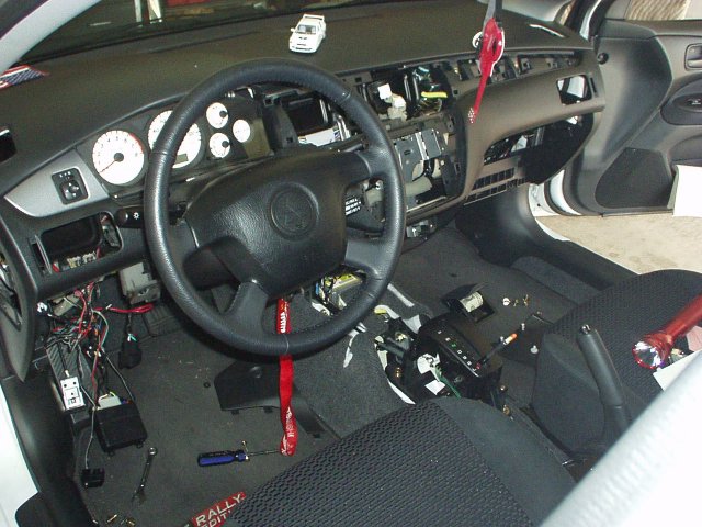

this is my dash when i took em out...
some bolt under the dash u will need a 10mm socket/wrench and a philips screw driver to take them apart..and that should handle well...some clip might break off..but its no big deal!

do you know where i can get a how to, to do this? I dont want to forget how to put it all together and have it lay like this forever.
