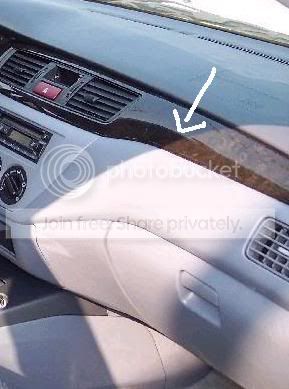

quik question re: the sanding...i know most of the interior parts are already smooth so i can just paint right over them. is the arrowed portion in this pic the only part i shoud sand? seeing as its a diff. type of surface...

here is a link to a how-to that i wrote for the SCLC. worked great for me, and a couple members took my advice came out sweet! ok (returning 10 minutes later) they erased my how too. sorry man use 600grt paper soap water, and vinegar. you'll be fine.

The only pieces I sanded were the door parts and the center console. Everything on the dash was clean and smooth, so I let it be. Be sure to wash everything. I don't think vinegar should be necessary, just a soap and water solution would work fine. I can't stress enough how important it is to properly prep, (and if you want richer colors) prime, and paint in MANY light coats. I think I did about 7-9 VERY light coats on most pieces. As you can tell by the general filth in my car and the glare off every painted piece in my picture, the finished result was well worth it.
