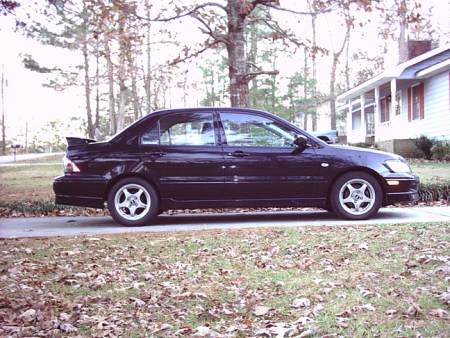

here is a pic of my car with progress springs.
u can tell a diff but hardly. the driving is really diff now. a lot tighter. quick question to those who have these on thier car.
how did u adjust the camber? we are thinking u have to drill a hole to the strut tower.. whats up?

get the OBX camber adjustment for the lancer on ebay. $50 and you're good to go.

rrm selss a camber adjustment i think. i'd rather buy from them, knowing they designed it for this kind of stuff. you dont really need a camber kit tho with progress springs...

but it has some positive camber right now...

It probably has negative camber if anything. Just last week I put my progress springs on too (pics soon) and the camber doesn't look too bad, but I'm taking it in for an alignment soon to see what the pros say.

I have the same set of springs from RRM. According to them they do not need a camber adjustment unless you drop the car more than 1.8 inches. If you do think that it does need the adjustment, I would just buy the kit from RRM, they put this stuff together, I would trust them on it.

rollerpyro it doesnt have negitive camber trust me i had a man who has been doing this for 15 yrs for a living put my springs in. it has some positive camber... now i just need a way to fix it.

i put the progress ES springs on my car and they dont make noises at all....thats all bull****. ppl who experience clanking or squeaky noises didn't install it properly. u gotta get 'em done right at an experienced shop.
mines work great, tight on the corners and very low (i'm like 3 inches off the ground!!) check pics.
dont believe any of that bull**** that ppl complain about making noises, if installed properly = no noise + works great. but if u have fat tires, u'll experience some rubbing on tight turns...like i do...... gotta get that fixed.
by the way, i hear the lancer can already be adjusted (camber) on the rear, not the front, hence why RRM only sells 'em for the front. however, the obx does both front and rear.
i have some neg camber on the rear wheels, like -1, but why bother aligning it in? -1 is ok i believe, and besides, handling is actually alot better with a bit of neg. camber.
surprisingly, my fronts dont have neg camber its perfect.
