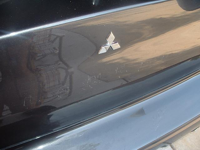

HERE ARE SOME PICS

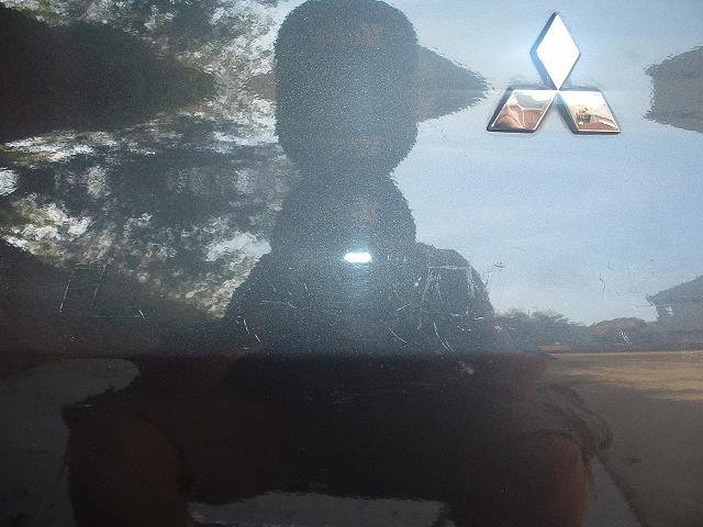

how did you manage to scratch around the edge of every letter?

my god man... tha hell did you take the letters off with?! barbed wire?!?? eeek.. you were saposed to use dental floss and goo gone\goof off or a hairdryer :-\ that sucks man -- i hope you can get it fixed!!

try turtle wax black scratch filler( looks like lipstick. Wax over with turtle wax, black filler wax. Then try buffing with mild abrasive 3M Buffing compound.

or...if u wanna try it...take some non-acetone fingernail polish remover.
put some on a rag and wipe it off...it came off 10x's easier than the goo gone crap. and after that i washed it really quick and waxed it, just incase the remover did something bad lol. but it looks perfect now and u cant even tell the letters were there...except for the little scratch there.
