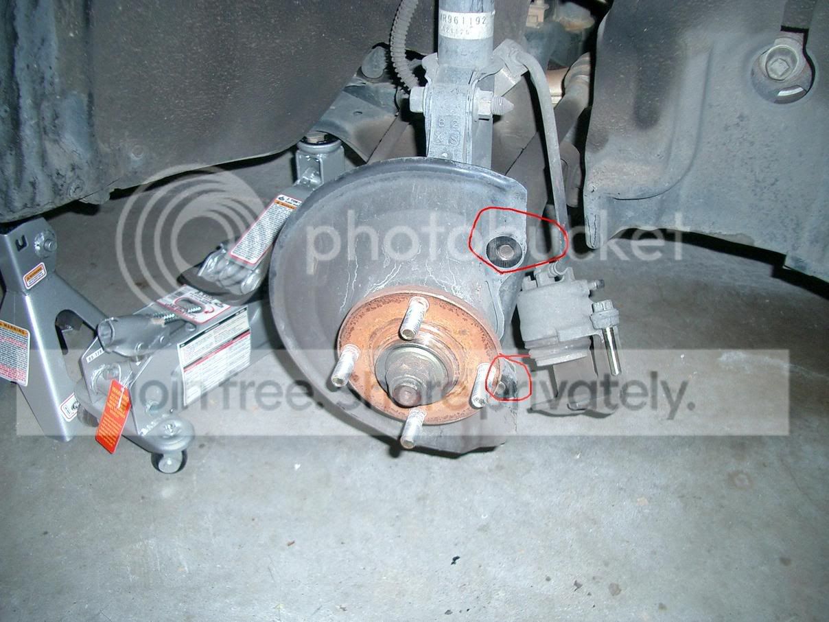

Looking at the wheel well this morning I noticed a small problem.... err large problem.
The "spacer" as I'm going to refer to it is moved so that I can't get the caliper back onto the car.
Spacer:
Top caliper screw:
Bottom caliper screw:
And I noticed this bend on the bottom of the "spacer."
Bottom up:
Side:
Please someone help me, I need to be able to get back to school on Sunday and the lancer's the only car I have to drive down there.

You've got to do something to straighten out that piece because that's what your calipe bolts to. You caliper has to be straight or your brakes will be very jittery at least.
-N

Any ideas on how to straighten it out?
Old Nov 25, 2005 | 08:01 AM
  #41
Blacksheepdj's Avatar
iTrader: (88)
Posts: 8,733
From: Concord Township, Ohio
Two flat pieces of wood and a C-clamp? Just put two strong things on either side and squish it flat...
