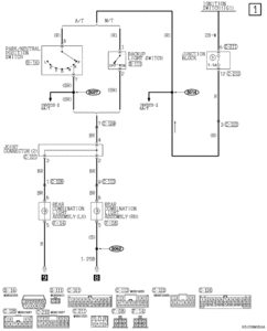

Originally Posted by msp
Does anyone have a tech manual pic or a pdf of where the switch is at?
Here is the location on a manual transmission diagram and the wiring diagram.
Attached Thumbnails where is the reverse light switch???-backup.light.switch.gif   where is the reverse light switch???-backup.light.switch.location.gif
