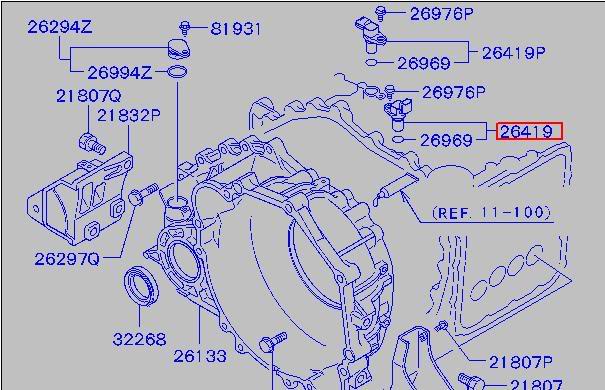

i know that both speed sensors are on a transmission .... how do you know which one is which .... are there any manuals or something with diagrams that somone can share with me.... i would hate to take it to the dealer..... to get it done......

Well, for one thing, the input shaft speed sensor and the output shaft speed sensor look different. When you actually look at the two, you'll be able to tell. The input shaft sensor (the one you ordered) has the electrical connector pointing up, whereas the output shaft sensor has the connector pointing off to the side. These pictures should help. The one boxed in red the second picture is MR331743.

so .... tehcnically i don't need to take apart the tranny it's external....? right?
Old Nov 7, 2007 | 06:25 AM
Tech@SA573's Avatar
Posts: 106
From: Missouri
Correct.
