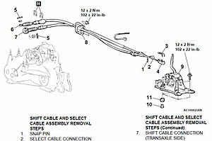

If you look at the attachement, the bushing inside #7 took a crap.
What are my options?

So here's my update. I went out and got bearings yesterday... took them home quickly realized the bearing is much too small to fit snuggly inside the ring of #7. It looks like a good match to #6 on the attachement, but as far as #7 is concerned, it's much too small. Unless I got the wrong bearing, but I'm no skater, so I just went to a skate shop and asked for their cheapest bearing set.
Anyhow... It looks like I might still be able to fit the thing in there... It will take some time and patience, but I can probably shave the inner bushing little by little until the bearing sits in there tight.

I bought a shortshifter off of e-bay, and it came with 4 shifter bushings all the same size, but on my car there is 1 big and 1 little one. I think on an eclipse or something they are all 4 the same size (or whatever car that is in the picture, didn't look hard) but my bushings are totally different, the 2 of them.

My biggest problem right now... The bushing that took a crap had a metal sleeve inside. That sleeve is now "rust-welded" to the lever pin... and the area its in, is not really safe for a blow torch operation
