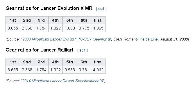

I had this idea as well, which is why I'm here. In short, all those guys saying "just get an evo" who sound like opinionated dumbasses, are right, and here's why:
the final drive ratios between all of the evo chassis and the RA are different, except the 4.529 of the 4/5 and 9.
"ok, what if i just get an x 5mt and ecu and call it a day?"
like i just said, the final drives are different between the RA and the X. on top of that, you'll need the manual harness.
"ok, that's fine, what if i just swap in an an evo 4/5 gearbox and a 4/5/9 rear diff?"
nope, can't do that,. because the 4g gearboxes won't bolt to the 4b, so you can't just swap in 4g stuff on the cheap.
so from this we can see that unless you've got a wrecked evo x, this is nonsense to bother with.
if you'd like to make the gt-s handle better, just lsd the front and whiteline everything. also you can source a programmable abs module or the fiesta st module/brake vectoring system if you want to improve cornering on the platform. the FiST weighs pretty much the same as the gt-s. otherwise, either get a ralliart and have the sst professionally rebuilt or get an evo. /thread
