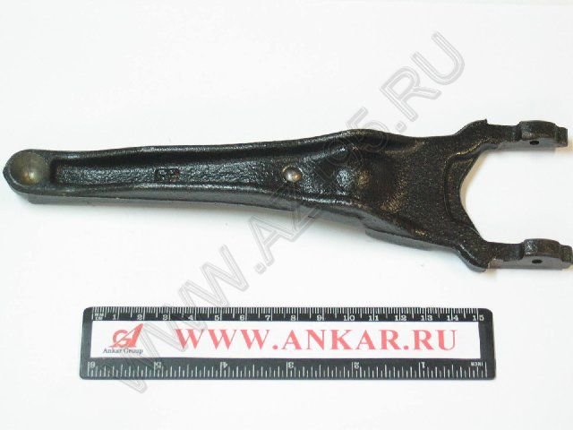

looking @ another thread here... I have found that I would need this:
and
that is the arm, the bearing, and the slave

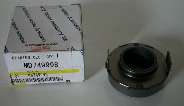

For a transmission with the "internal slave", you would only need this piece. it is the bearing, with the slave cylinder integrated...

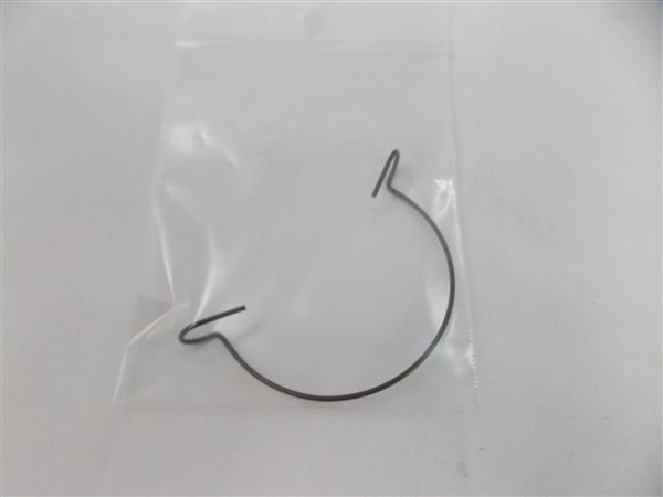

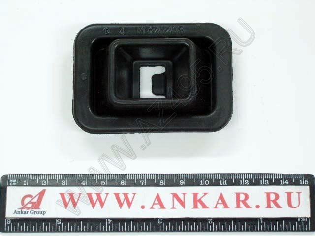

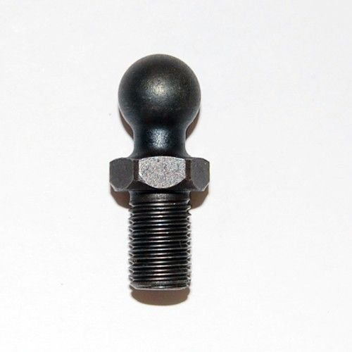

For an external slave system, would need this, yes:
however, if the transmission doesn't come with it, you would also need;
this:
this:
this:
this:
and this:
along with the appropriate bell housing, if the one you have will not accept these parts...

ah ok, I thought that fork I posted didn't look right....
looks liek I posted the fork what what I already have, the 03
