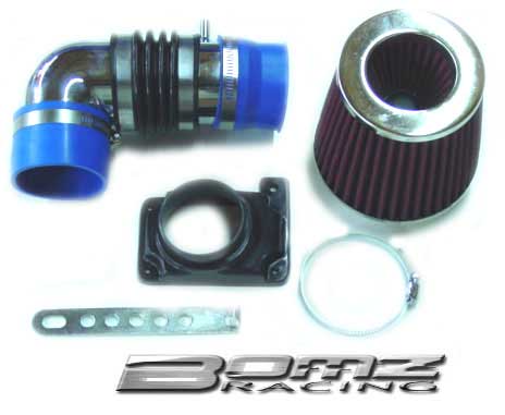

i just received my Short Ram intake system today , the only problem is, its not as easy as i thought . this is TOTALLY different from a civic, my civic was done in about an hour.
the lancer one is weird...u got the stock filter with the scoop connected to the front grill....i'm told that i keep the front scoop intact, but there is also the chip on top of the stock filter.

i got the BOMZ Racing Short ram.
check picture.

Hey man , invest in some vise grips to get those nasty bolts of the stock intake box you may break the box or stock nuts many already have but thats kinda how they came to the conclusion to use the vise grips .. other then that it looks pretty much simple from the pic i like that adaptor at least it's not a 4 inch 1 and you won't have to run around lookin for a 4 to 3 inch piece to connect the filter.. hope that helps you some, and hey try to see if u can make the stock intake scoop get as close as possible to that filter i say this cause you don't have a heat shield so any lil bit of cold air you can get would be good... with my custom intake it sits just about right behind the slits in the stock grill so i kinda just force the air right in ya know..... but nice setup and good luck..

Who said to keep the front scoop intact? Is that what the direction with the intake sytem said? The only short ram intake for Lancer's that keep the front scoop is RMR as far as I know. But I have never heard of BOMZ Racing intake for our cars so I don't know if their setup is similar. Just be careful with the bolts on the MAS.

Take the ENTIRE intake section apart up to the throttle body. THEN put everything in your aftermarket intake on. Save or scrap the stock stuff. It's that simple.
