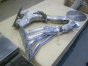

Anyway you guys could post pics of the installed header, and or pics of the stock manifold? Thanks

Sorry for the crappy cellphone pic, but it's all I had at the time
Oh, and ignore the Mitre saw blade - it didn't come from the car

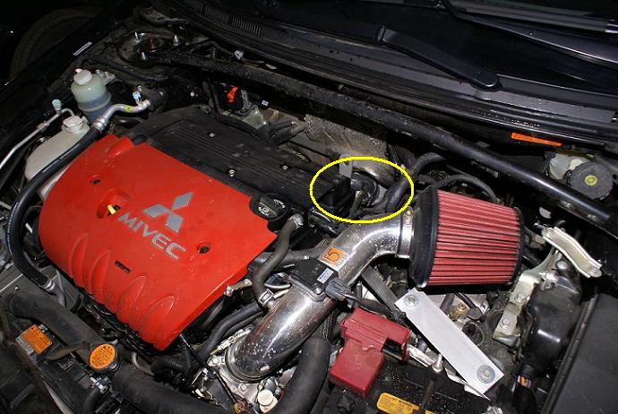

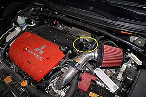

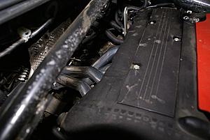

OK, here are your installed pics. I've got to say, there isn't much to see from above the engine - if you really want to appreciate it, you have to see it from below
Oh, and sorry for the filthy engine bay - I just got back from a 2-hour drive in the snow.
