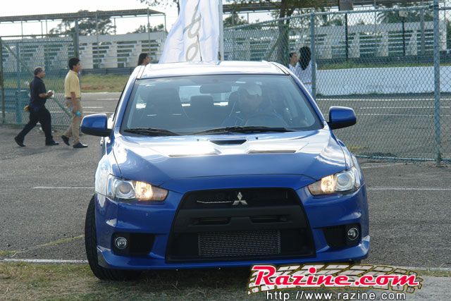

the Lights That Look Around Corners AFS (Adaptive Front Lighting System) when the driver turns the steering wheel and automatically switches on an additional beam to light up the oncoming corner. The modification was to make both (left and right light) to remain switched ON and then when i want it to turn it off through an alternative switch button, now i have an AFS! message in my tachometer panel. how to turn the message alert off?

what steering lights, and what modification. Please explain.

You cannot turn it off, it is checked by the ETAC computer that is inside the car. Best thing to do is check the wiring!

The US lancers don't have that. I guess you probably can't reset it (as many other things such as the tire pressure sensor). Just an idea: wire the lights directly to the switch and battery using your own wires and connect the existing wires to some resistors where the lightbulbs are supposed to go. That would close the circuit. Anyway i've never seen the way that those lights are wired so I don't have a clear idea.

will u take some pics of these lights please?
