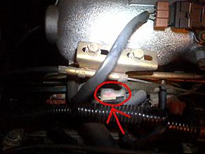

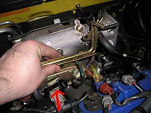

Found another picture from this forum (https://www.evolutionm.net/forums/la...ll-w-pics.html) that I hope the poster Alchemist doesnt mind.
If anyone knows what this black box (maybe a sensor) is please let me know. I would like to order a new one since it is making a clicking noise. Thanks!!

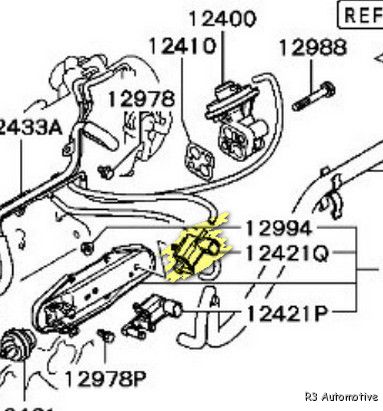

it's a valve that is part of the evaporative emissions system. It is a solenoid, so clicking would be 'normal' I guess, there's nothing in the service manual about what noise it should be making during normal operation. Here are the tests in the FSM to test that valve:

I'm wondering if this might be the part that's messing up on the cars:
EGR Solenoid
MR127520
It's on ebay for $75. The EGR valve is $95 on ebay, as opposed to $143 from rockauto. Apparently the Montero uses the same EGR valve (96-06)...
