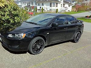

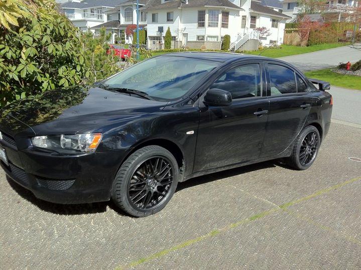

So I finally got rid of my stock 16" tires and rims and got 18" FK452 225/40/18 tires with Enkei EKM3 rims. It looks great. I noticed, however, that when my steering wheel is straight, the car tends to slowly pull to the left. I have to keep my steering wheel slightly to the right in order to keep the car straight. Is it because I have to align after getting new tires? The shop didn't tell me anything about it.
And here's a pic if you guys wanna see how it looks. (Yes, I need to lower it... and wash)
