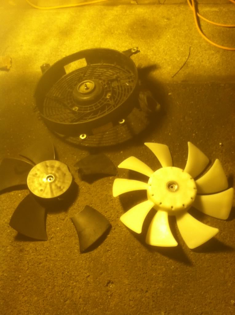

Hey guys I just noticed on my 03' Evo fans won't come on by temp but will come on by ac or shuting car off. Is the the fan relay or fan control module? I had cooling fan blade break off and made the fan get stuck so it wouldn't cool. Replaced with new fan and went to make sure fan would kick on by temp and it didn't. My temp gauge has ALWAYS stayed on the water lines just below half on temp gauge. Let it get just above that to see if fan would come on it didn't so drove around block cause its EFFEN cold here:-) So what's your thoughts?
