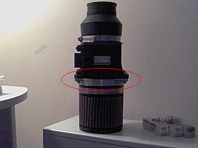

I know you don't have the RMR one otherwise you wouldn't be having this problem. I was telling you that you need an adaptor. Round hole to a square hole in essence. Look here at this other custom intake. Notice the silver bracket highlighted in the oval. You need to acquire something similar. Ask member loneeemeeee for assistance if necessary.

Thats a pretty cool intake, did you make it for your Lancer?

I made that with parts from home depot and RRM.

If you drive a manual that smell is probably your clutch either that or you are burning up catalyst. The part I got from home depot was the 2 1/2" to 3" connector($6) I got the MAS adapter plate from Road Race Motorsports with my original short ram intake. I'm sure Rob would be more than willing to sell you just the plate.

I just wanted to stress some key points that might have been missed:
-Make sure the filter that you have has a 4.5" inlet opening. Most filters are 3"
-Make sure the MAS adapter that you get is 4.5" and not 3" (this will be a given if you order it from Road Race)
-If the filter that you do have is 3", you still need to get a 4.5" MAS adapter, and a 3" to 4.5" reducer sleeve as well to connect the two (an adapter for your adapter essentially)
