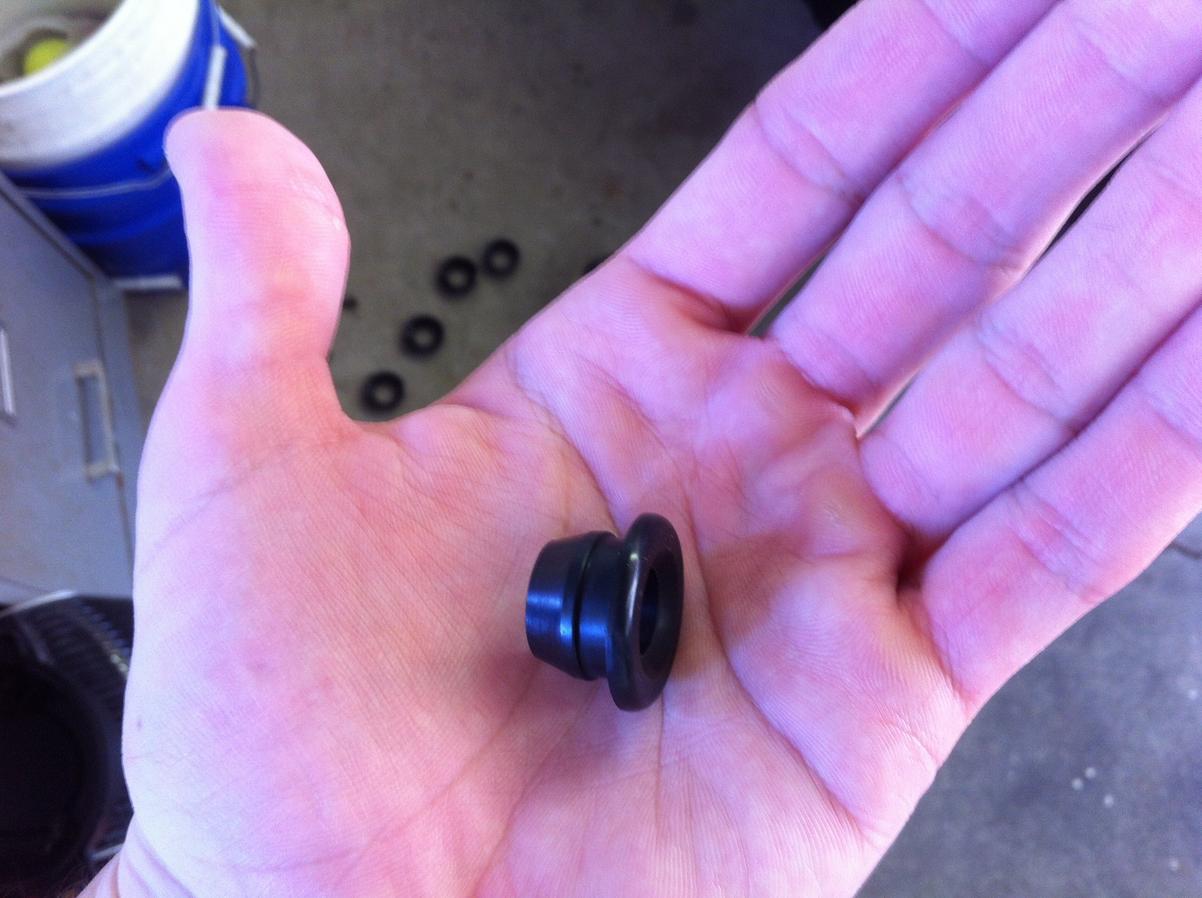

Where does this gasket go? It came with the kit of 4 spark plug gaskets and the large valve cover gasket. Thanks!
I'm not entirely sure myself. Looks possibly like a seal from your coil packs to plug wires...maybe?? My wires and plugs are NGK since I've owned the car and never seen those
Just a guess...
