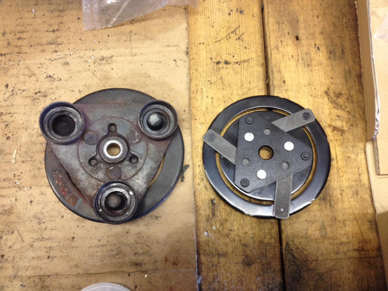

Finally doing these fixes.. Can someone verify the parts I received are correct? They are generally correct but the anti-rotate pin in the round inner electric part (name??) is in different location. It seems like if the pin isn't in the hole it won't sit flat on the compressor and it may rotate. Thanks.

must have missed this thread early on, but i picked up an evo compressor used here on the forum, 150. Has worked fine for 5-6 years. Realize you now have parts--they will work as long as the compressor isnt the issue, as it has been with mine. GL
