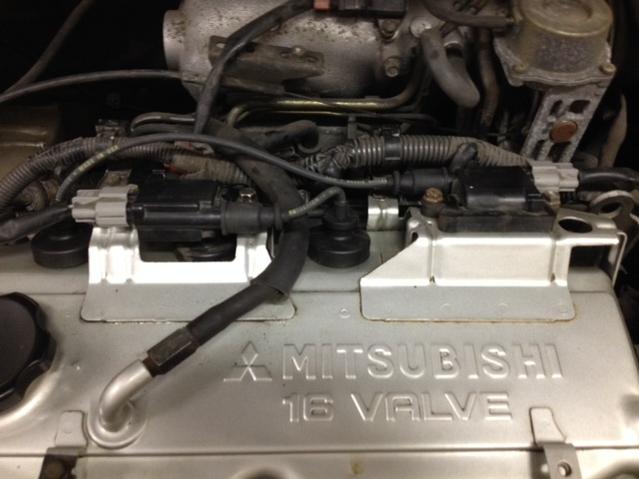

I searched everywhere for information matching my issue, could not find anyone with my particular problem. I recently bought this super-clean 2005 Lancer ES and decided to do the valve cover gasket, the plugs, the two accessory belts, the timing belt, the water pump and the tensioner. Before I did this, the car ran fine but the belt had never been done. No codes. Put it back together and it ran like crap and throws the P0303 code. I rechecked the timing marks, they are exactly on, I never turned the crank during all that work. I bought new spark plug wires and that changed nothing. I swapped the coils, same code, no change. I replaced the #3 plug with the old plug, no change. Two plug tips are white, two are black (the #3). Vacuum lines were never touched. I am mystified. I really don't want to buy an injector if I don't have to.

Slight error found!
Found the issue. I am an idiot sometimes, take a look at the pictures below. The first photo is the wires done wrong, and the second is the swap to the correct routing.
The wire from cylinder 1 (far left), goes to the right coil, not the left coil.
The wire from cylinder 3 goes to the left coil, not the right.
How the car ran I will never know! It ran poorly, but ran. P0303 problem solved.
