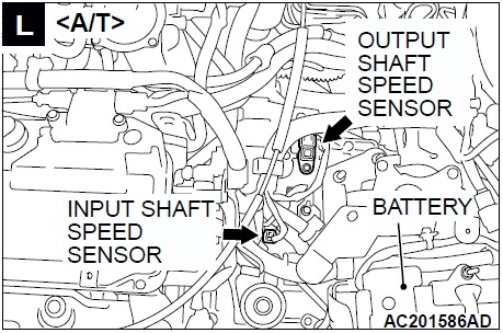

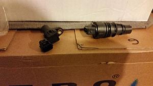

Hey everyone , my speedometer doesn't work , its been like that since i got the car. So i thought i should finally fix that. I purchased the Automatic Transmission Output Shaft Speed Sensor and Input sensor.
I had tried to look for the location of the input sensor and i found two locations where i could put it. The first place it didnt seem o line up with the screw holes. The second place i tried , it fit bt the car wouldnt turn on so that obv, wasnt the right place to put it. For the output shaft sensor i have no idea where it goes. PLease help i go back to college soon and would really like to get this done!!

Thanks , ill try my best to find it but if its not too much to ask can you send an actual picture .

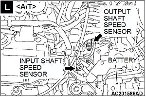

The output is on the right input on the left
I cant find the place

Heres pic
Attached Thumbnails Input and Output sensor locations ?-forumrunner_20141115_203319.jpg

there should only be 3 harness connections on the top of the transmission...input and output speed sensors, and the main control control connector...
