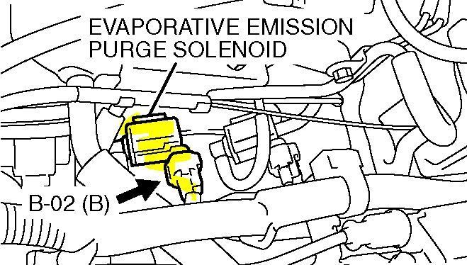

So i got this code on the 03 OZ-Rally.
P0456 Small leak on the evap side of things. Googling around it seems the purge valve is the likely suspect. Evap purge seems to be part number MR507781 @ $60ish.
Its the yellow sensor. Looks to be held on by a 10mm or 8mm on the back side on a plate. Its a little hard to reach back there, and i would imagine it would be a pain to get that nut back in place.
Looking at this image, #5 is my purge and number #6 is a EGR. But #4 is the whole plate. But i'm under the impression that #4 is EVERYTHING including 5/6 which runs $115. But i dont know exactly how it bolts on, their seems to be 2 top bolts where the throttle body cable bolts to but thats it.
1.Thoughts on this at all?
2. Is there another place to get the evap sensor ?
3. Any tips on installing this?
Anyone have similiar issues

So i did a little work on the car. Finally had some time.
Pulled that evap solenoid and tested resistance, it was within spec (i think 39ohms). Also applied 12v to it and i felt the click internally. So that works. Inspected the little U shaped lined and found it to be pretty solid. The other line that runs to the driver side looked good as well.
I crawled back to the canister. Checked everything and tugged a little bit. Everything seems to be intact and solid connections all around.
For good measure i bought a Fuel cap from advanceauto.
Drove around and this time i got a P0442, SMALL EVAP LEAK instead of the P0456 which is VERY SMALL evap leak. LOL seems like i'm going backwards.
Kinda out of ideas. Might ship it to the shop.
