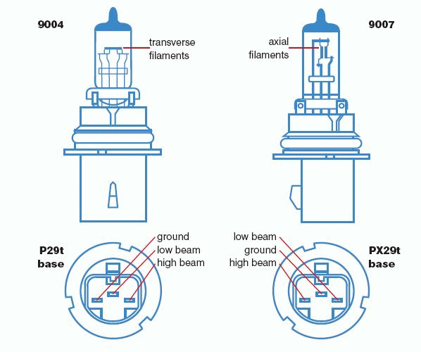

So I replaced the stock harness with aftermarket ones but my lights don't seem as bright. Yes I know, rookie move not to take a picture of the wires before I removed anything. If someone could please post of pic of both harnesses as they should as they should be connected, that would be awesome. Thanks.

Yikes. Should've marked everything. Anyway... hopefully someone chimes in with some info. Did you try running a search? Worth a shot.

Yeah I know... i did search but to no avail. Seems like ppl aren't as friendly as they used to be on theses boards. Thanks for taking a look. Even a picture would help.

Have a test light? You can use this pic as a guide and test your wires to see if they match up....
