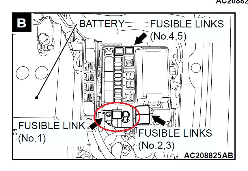

Check the fusable link. Replace if broken. Designed to melt in this scenario.

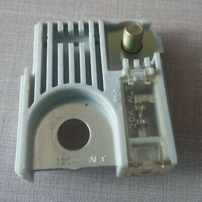

If I'm not mistaken , That little guy protects the alternator. The link between the battery/alternator to the rest of the vehicles electrical system is fused here:
This is an evo though, so maybe different on a lancer? Either way, it needs to be replaced if it's blown.

Yes that was it thank u for help it was also 1 fuse under dash
