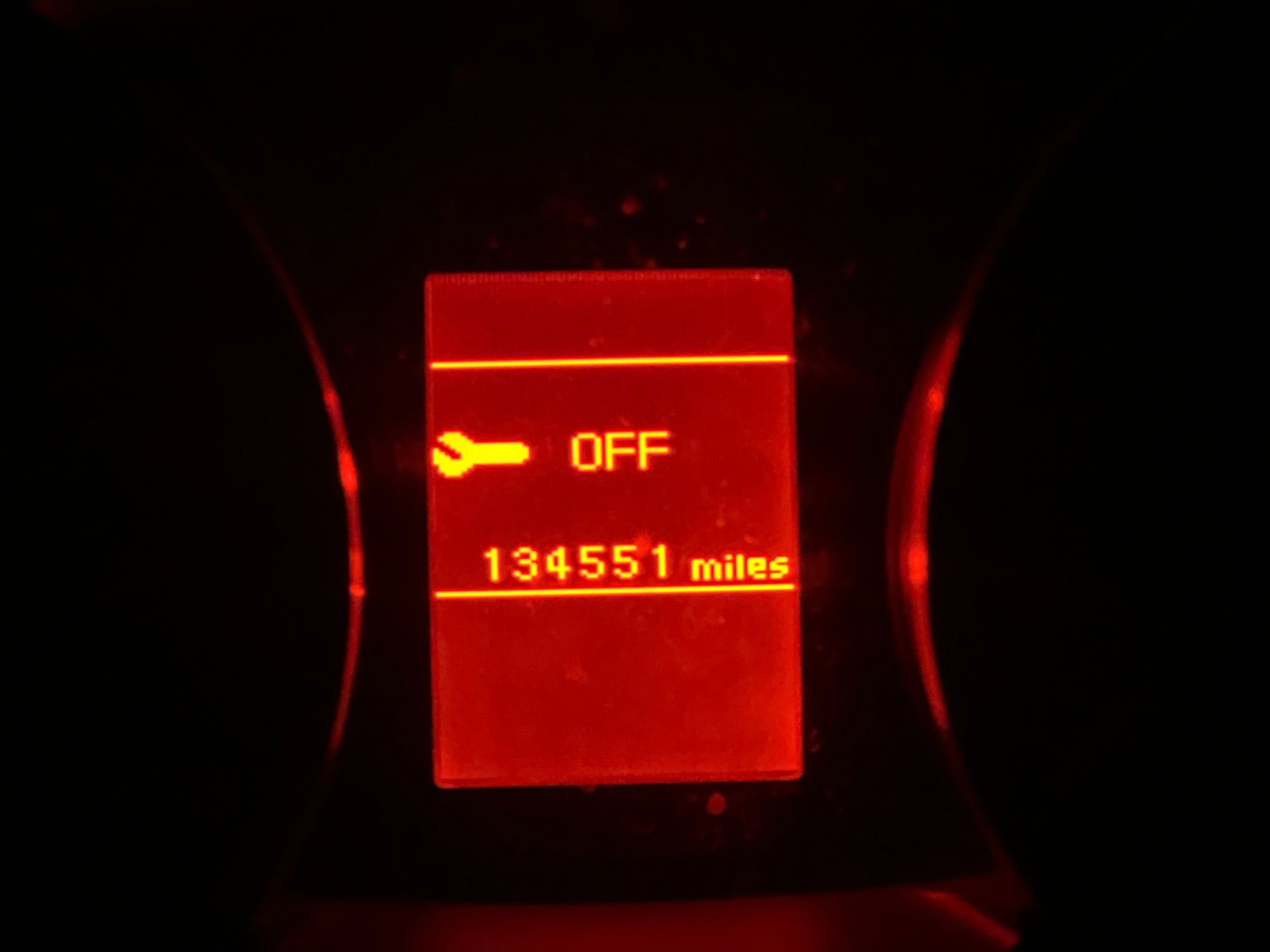

Next to the wrench in the dash display settings is indicating that it’s off. Cannot get it to turn back on no matter what I do. Previous owner had it off. I’ve tried everything.
Much appreciate it if anybody can help me out.
thanks.

Maybe disable through EtacsDecoder?

I don't know if you have fix this already but it's a non-user friendly way to do it. With the car off, ACC at best, you will cicle the screen until you go to the maintenance tab,
then you will hold the botton until you hear the beap
after you will press it three times (you should hear three beaps, each for press)
and then you will be able to change your maintenance schedule.
Maybe I'm not 100% accurate I did it a while ago and haven't done it since.
