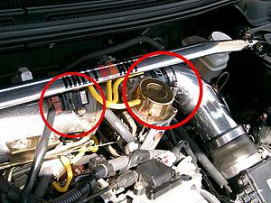

ok... i've circled the gold cup u guys are talking about.. but it doesn't look like mine would hit that even reving up.... but i also circled that little module... does it maybe hit that? hits something though cause in reverse it's like a grinding sound....

well nevermind.. i went to the garage and fixed it... there's two nuts at the end of my strut bar where you can twist it... i twisted it as far backwards as i could... no more rubbing... i don't hear that sound anymore... maybe this may help people who have bought this bar.
