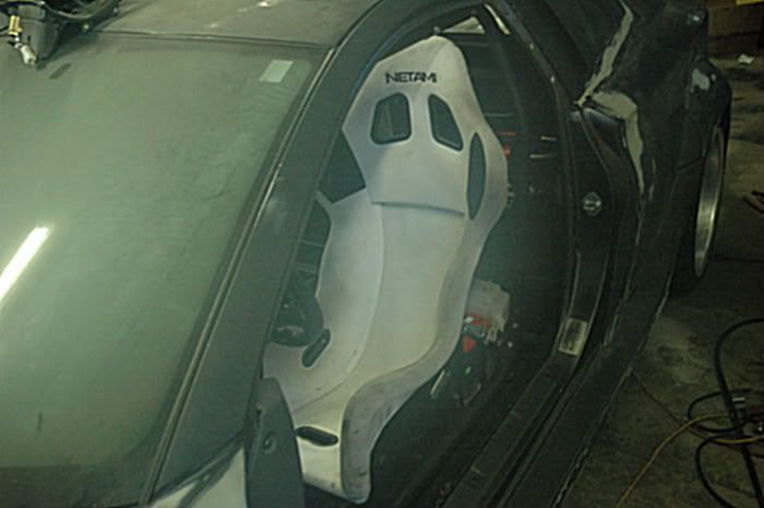

And with the Seat in, in its full back position:
Pic of the drivers seat:

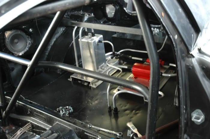

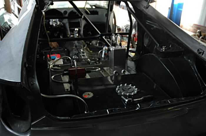

Here is a shot from the rear. Fuel assy all in and working good. There are a couple more pieces of the dash I need to install so the next pics of this will be of it finished and with the seats in for good:
