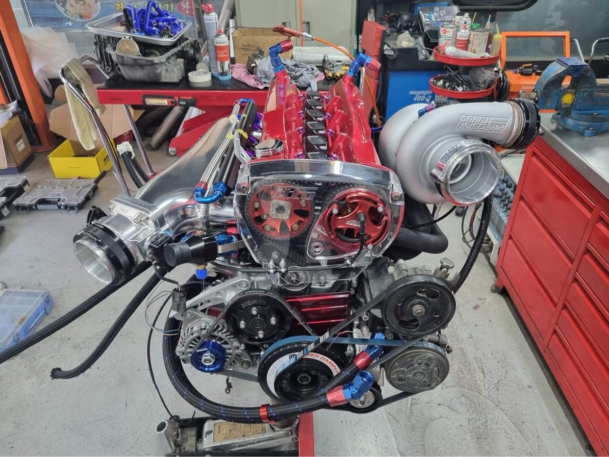

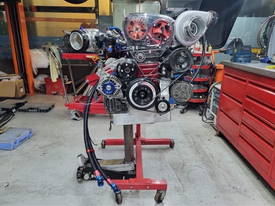

-Most recent build is a forged RB30, RB26 head and single precision 6870 turbo (owner sold his rb28) went out for the ecu setup and retune on this late 2022. Sense I see the customer also posted for sale but the prices in Korea for these are even higher than the states… I have a hunch he is planning to hold onto the car for a while still based on that price.

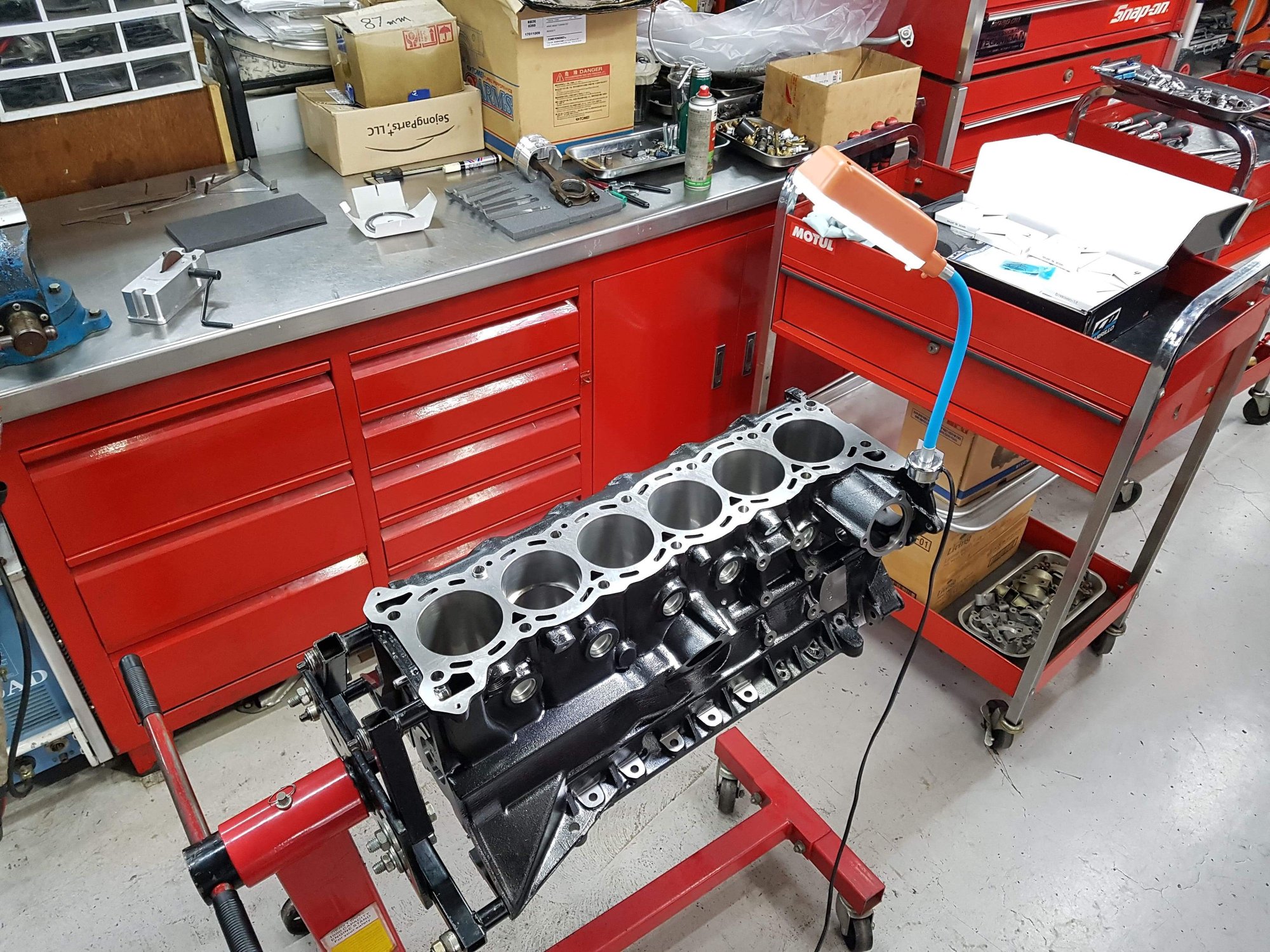

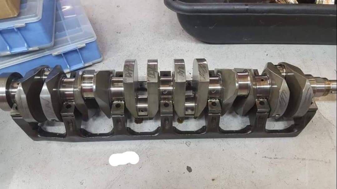

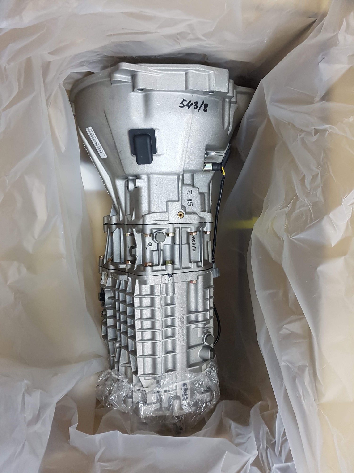

Some pics from the build
Tomei Rb26 stroker crank

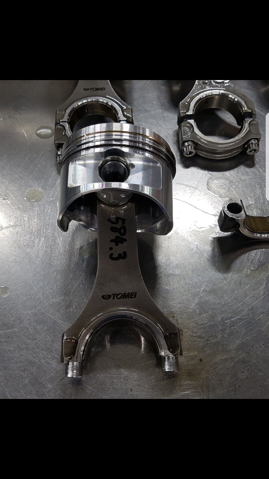

Tomei rods and custom Cp pistons

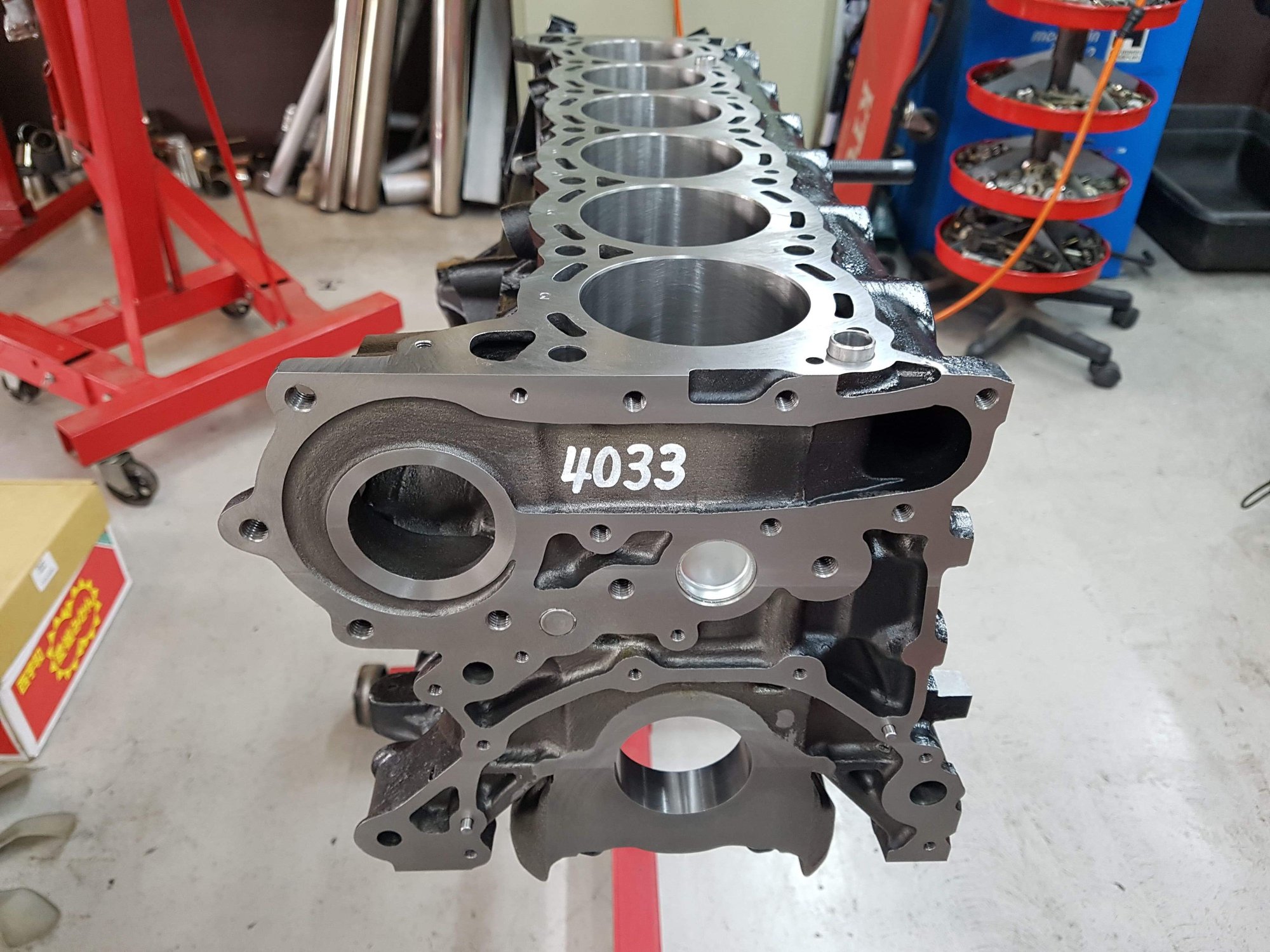

New from Nissan Rb26 block
New 6sp transmission

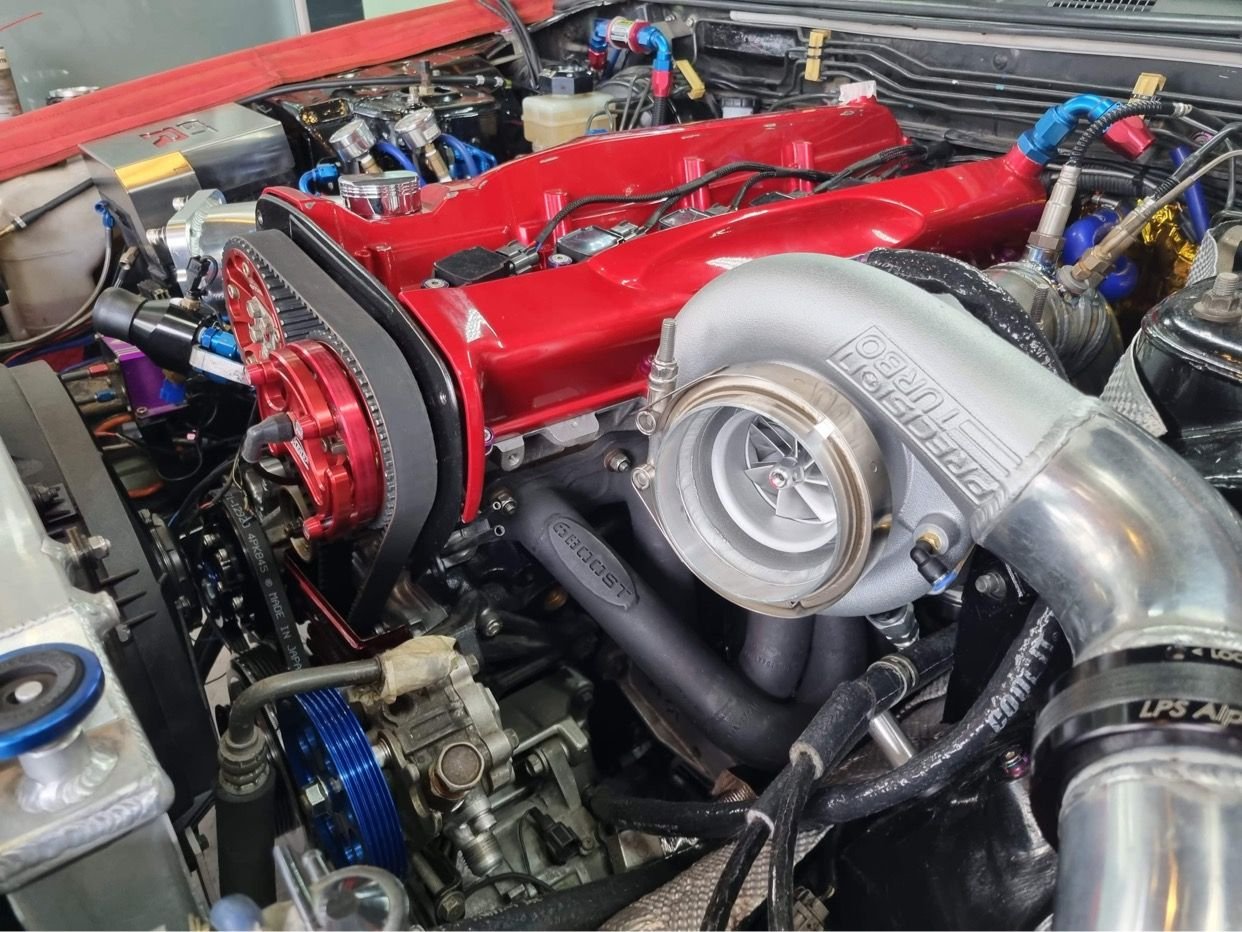

Shoot forgot to update this one after the latest rb30 setup and retune. The owner also posted it for sale but based in his price I don’t think he’s very interested to sell it haha.
R34 GTR 1999 for sale
First of all damn the car is maybe the perfect street car power delivery and made 802hp. New rb30 and ported head do wonders to get the big precision turbo moving. Unfortunately the dyno the customer rented was terrible so I’d like to see clean runs on a proper dyno for real numbers. 95% of the tuning had to be done driving the car as you’ll see the dyno couldn’t produce anywhere near enough load.

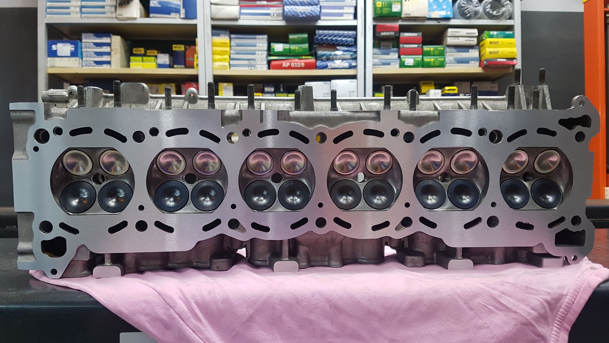

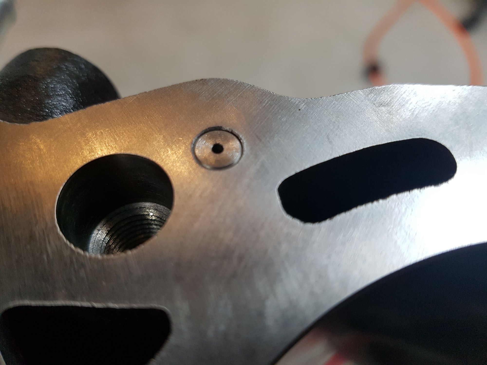

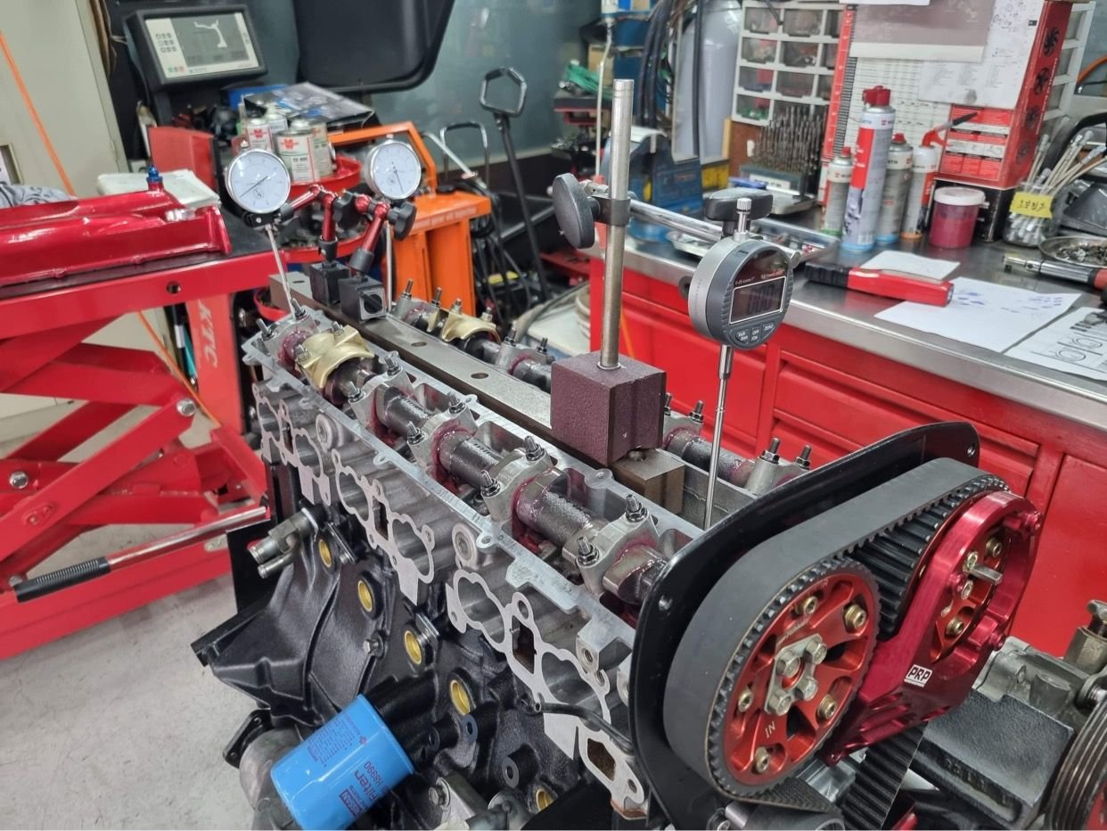

freshly built RB26 head
If you've ever owned an RB you know this lil guy

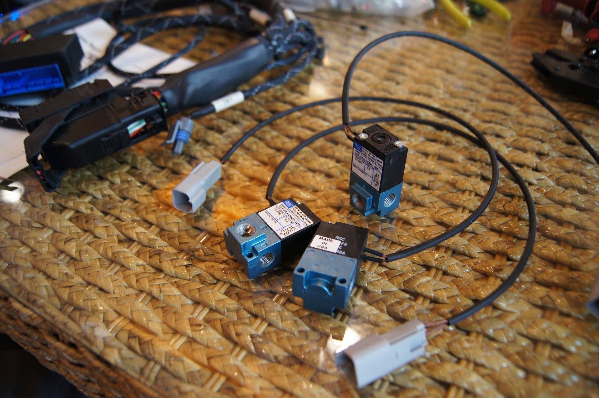

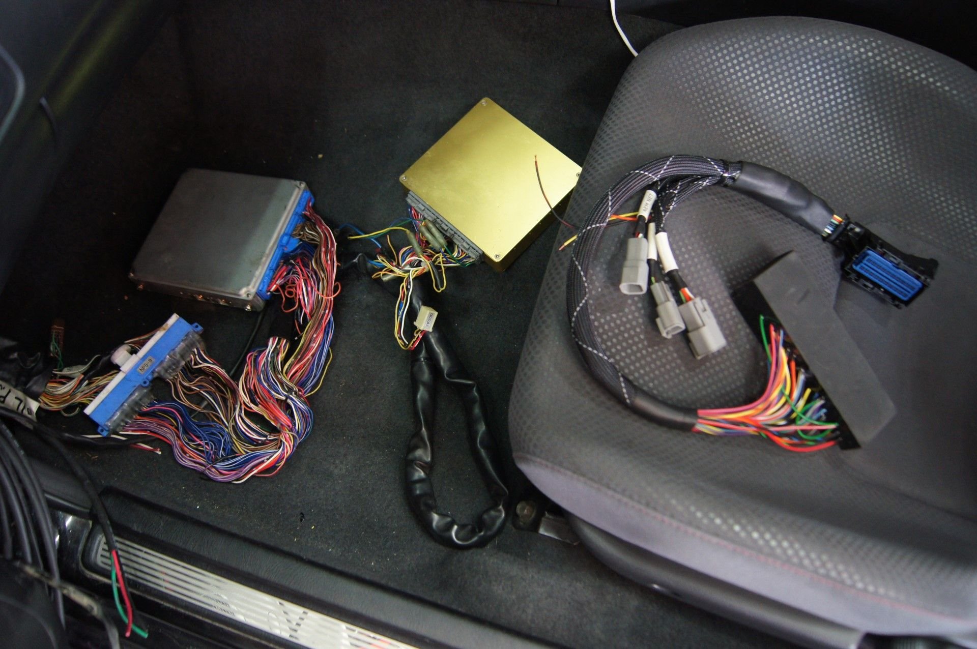

ECU controlled boost ALWAYS
Old Hks Fcon comes out
