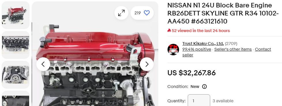

The RB26DETT is a sexy heritage engine, pretty much like a heritage watch now. That said, she is quite a bit more pricey than the popular GM Connect & Cruise stuff.
If I were to have the RB26 one day, I would prefer keeping her mostly stock. To me, a reliable stock(-ish) engine hauling me and women for a decade beats one modified with JDM bling that impresses mostly male nerds.
