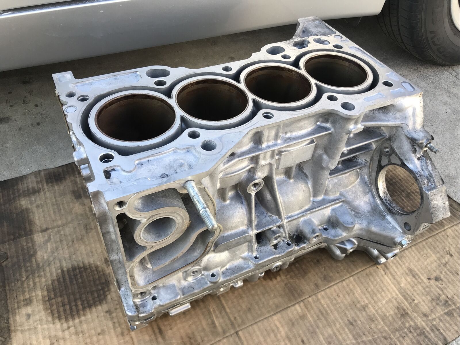

Been told this is a K20 A2 out of a 2004 RSX. Does this look right to you guys?
Confused about the open deck configuration and its ability to hold high HP (turbo power). I can see if it was sleeved!
Good topic for sure! (caught my interest)
Looks like a K20Z1 from 05-06 RSX-S, the stamp is right in front of the starter hole.
My main concern is the open deck design. Not a good comparison between the closed deck 4G63 & this open deck design. The K20 seems to need a sleeve job to be able to hold high turbo type HP.
But from a NA point of view, Im sure, based on all the great comments that this NA motor is just one of the best!
Even open deck it still holds massive power, I think people only really sleeve when going 800+whp. But it can pretty reliably hold 500 even open deck. Honda's rod ratio and mean piston speeds are what make them work so well and be so reliable even with big power. I've seen plenty of people make around 500 with single cam D-series open deck blocks. Honda just take abuse and asks for more.
under normal circumstances yes, open deck can take basically the same power as closed. Its when an issue arises, running too lean/rich, detonation ect where the closed deck will be more likely to sustain possible engine failure that the aluminum open deck head surface/bores would warp/crack under.
